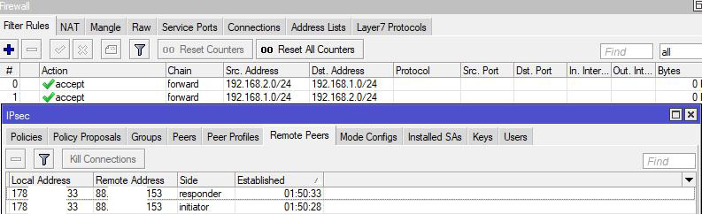

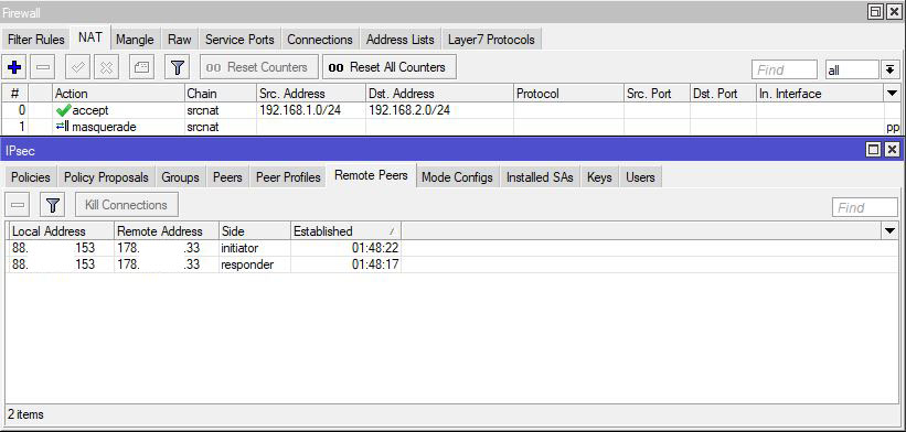

I have SITE1 ↔ SITE2 connected via IPSec tunnel
SITE1 192.168.1.0/24
SITE2 192.168.2.0/24
As you can see above IPSec tunnel works and rules added but the traffic not flows on it.

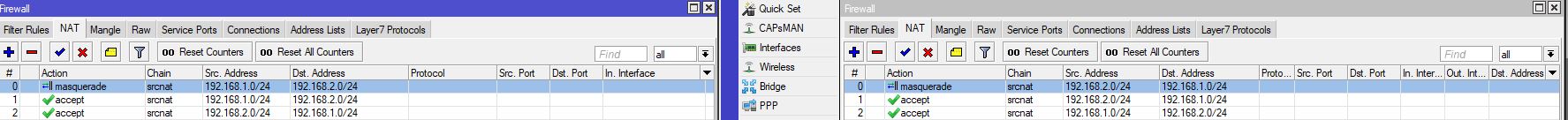

This is just a guess but probably worth a try:
Your default masquerade rule in both sites has no src-address specified which leaves plenty of room for interpretation and I wouldn’t be surprised if tunnel traffic from the remote site gets masqueraded right away and comes out of your LAN-facing interface with your local router’s LAN address as source.
Try adding NAT accept rules for the other flow direction as well and probably add your local subnet as src-address for the masquerade rule.

Hi cdiedrich!
Thanks for your reply. I added them to NAT but no luck.

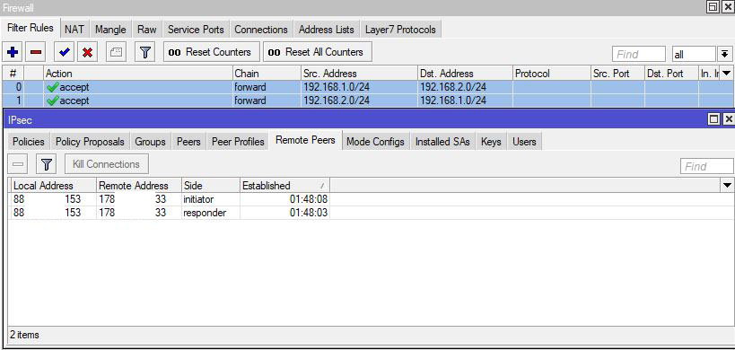

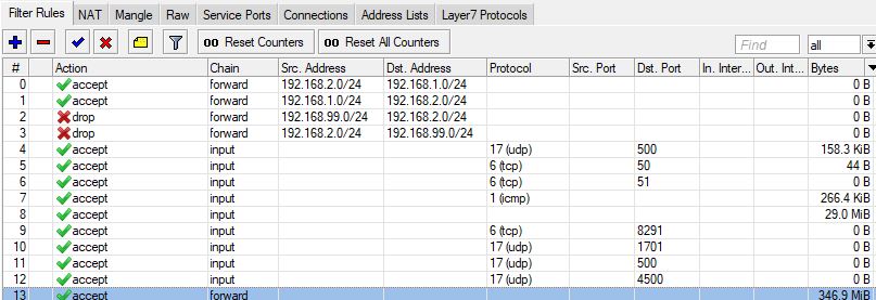

There is a default rule “accept” - “forward”. This can cause this anomaly? (I can not really make experiment to turn this rule-on/off" because these are production devices.

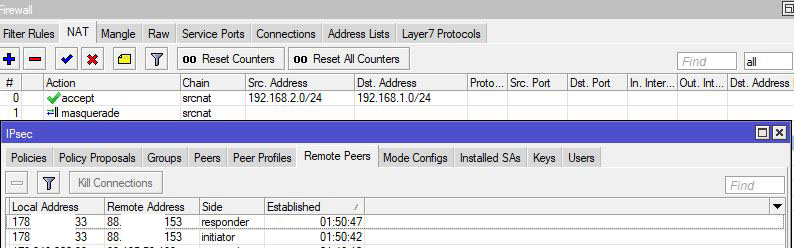

Insight:
looking at your screenshot, your masquerade rule doesn’t have a matcher for src-address. It may happen (that’s still my guess, but it’s not unlikely) that traffic from the remote network gets caught by this rule and then gets masqueraded, leaving your router via pppoe-out1 (when I read your screenshots correctly)
instructions:
Add src-address to this rule (that would be 192.168.1.0/24 for site A and 192.168.2.0/24 for Site B) on both sites.
With this in place, traffic coming in from the other site will not be caught by this masq rule. Normally the accept rules above that will handle this…

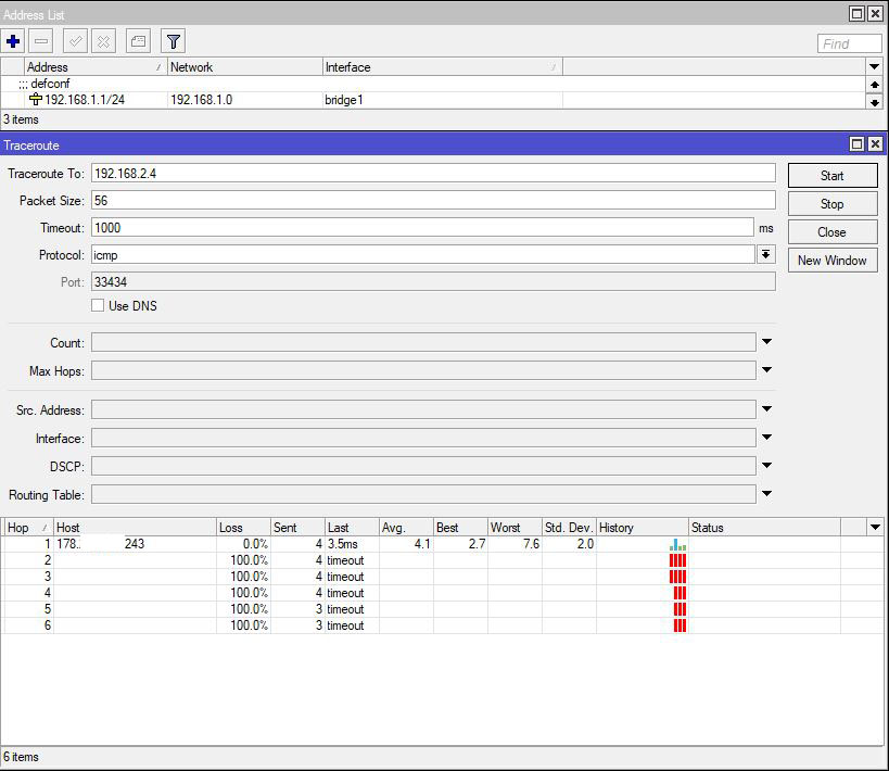

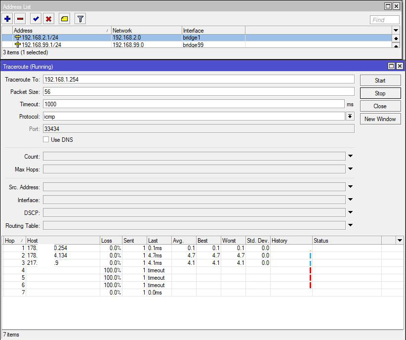

The truth will be somewhere there that the router not pushing the traffic into the tunnel.. it can be exactly seen on traceroute.

I have seen in your screenshots that you open 4500 UDP port, but I believe you are missing protocol 50 (IPSEC-ESP). That is used to transport de encrypted traffic once the tunnel is establish, so if you don’t allow it, the tunnel is established, but the data does not flow.
add action=accept chain=input in-interface=ether1-wan protocol=ipsec-esp
