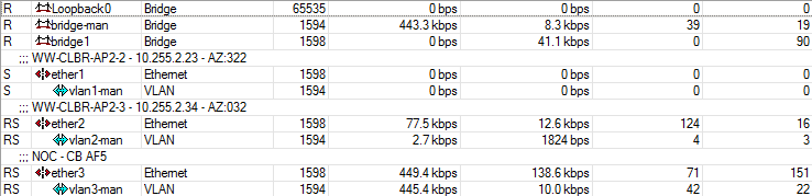

So, i am no networking tech obviously. This is a cap of what is at one site we had an issue at prior to my initial post. Radio on port 2 (which is 10.255.2.34 addressed) can normally be accessed from the office with its IP, however a tech accidently kicked it to SM mode and cause some issues. All of our radios can be accessed at the web page of 169.254.1.1 (when plugged into them with a 169 placed on the computer)
Obviously i cant load a 169 from the office, which is why i was looking at if we can forward another ip to the ether2, basically any communication to 10.10.5.50 hits port 2, translated to 169.254.1.1 to the radio.
On this tower, ether3 is the feed link from the office

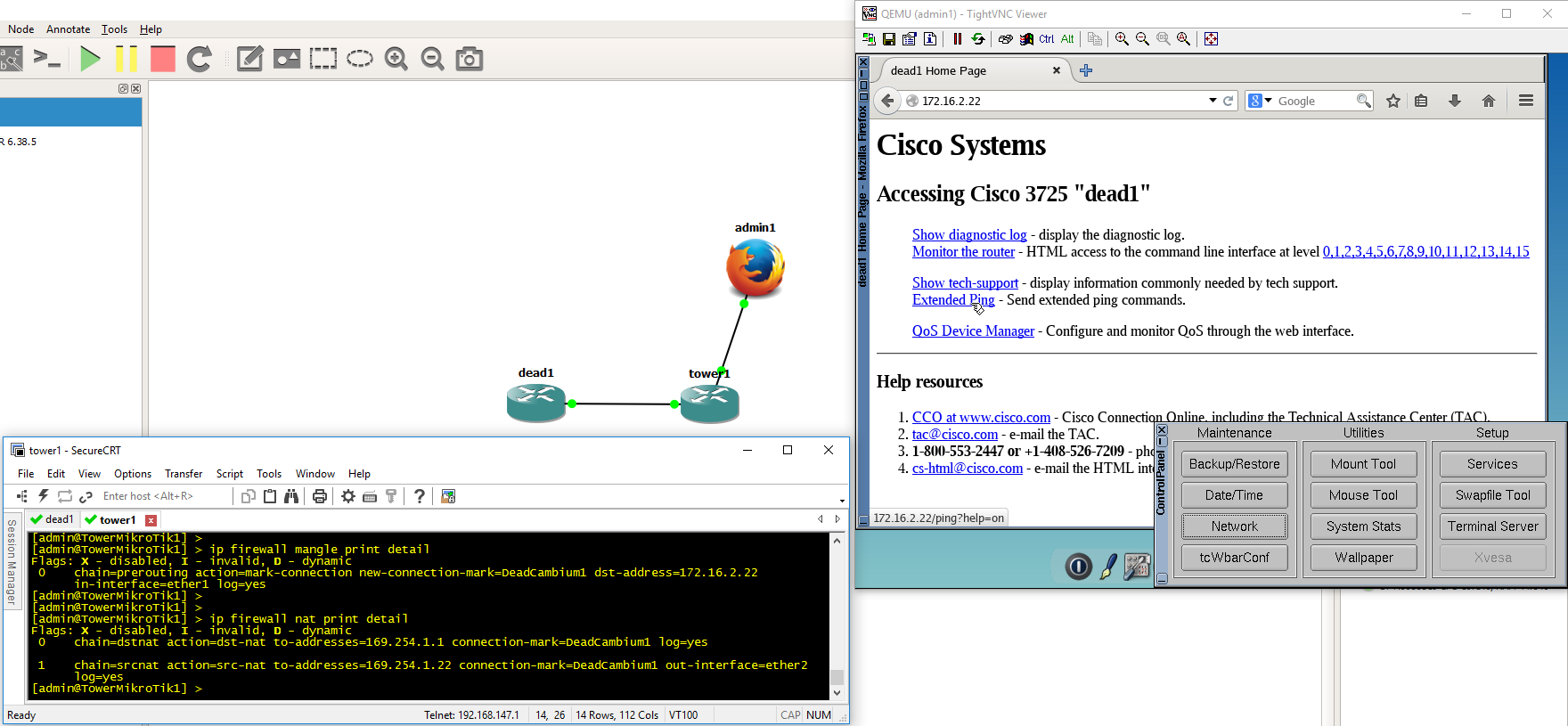

A correction! I labbed this up quick and it seems to work. You probably don’t need the mangle. See the attached picture.
/ip firewall mangle
add action=mark-connection chain=prerouting dst-address=172.16.2.22 in-interface=ether1 log=yes \
    new-connection-mark=DeadCambium1
add action=dst-nat chain=dstnat connection-mark=DeadCambium1 log=yes to-addresses=169.254.1.1
add action=src-nat chain=srcnat connection-mark=DeadCambium1 log=yes out-interface=ether2 to-addresses=\
    169.254.1.22
The list of IP addresses on the dead device (you’ll see it only has 169.254.1.1):
dead1#sh ip int br
Interface                  IP-Address      OK? Method Status                Protocol
FastEthernet0/0            169.254.1.1     YES manual up                    up
Serial0/0                  unassigned      YES unset  administratively down down
FastEthernet0/1            unassigned      YES unset  administratively down down
Serial0/1                  unassigned      YES unset  administratively down down
Serial0/2                  unassigned      YES unset  administratively down down
Serial0/3                  unassigned      YES unset  administratively down down
Serial0/4                  unassigned      YES unset  administratively down down
Serial0/5                  unassigned      YES unset  administratively down down
FastEthernet1/0            unassigned      YES unset  administratively down down
FastEthernet2/0            unassigned      YES unset  administratively down down
dead1#
*Mar  1 00:06:10.723: %SYS-5-CONFIG_I: Configured from console by console
dead1#
I used a Cisco device to simulate my dead cambium device because well that’s what I had and it was different than a MikroTik. I used a tinycore Firefox appliance that comes with GNS3 to act as the Admin PC back at the home office.
These rules can be active all the time and you likely could filter the traffic in some way or you can like you said enable them on demand.
I used the IP 172.16.2.22 semi-randomly. It just needs to be an unused IP that would or could be made to route to the MikroTik in the tower. You could even re-use the Cambian’s IP but then you’d be in a situation where you had to toggle the rule on and off to get desired functionality.
Good luck.
