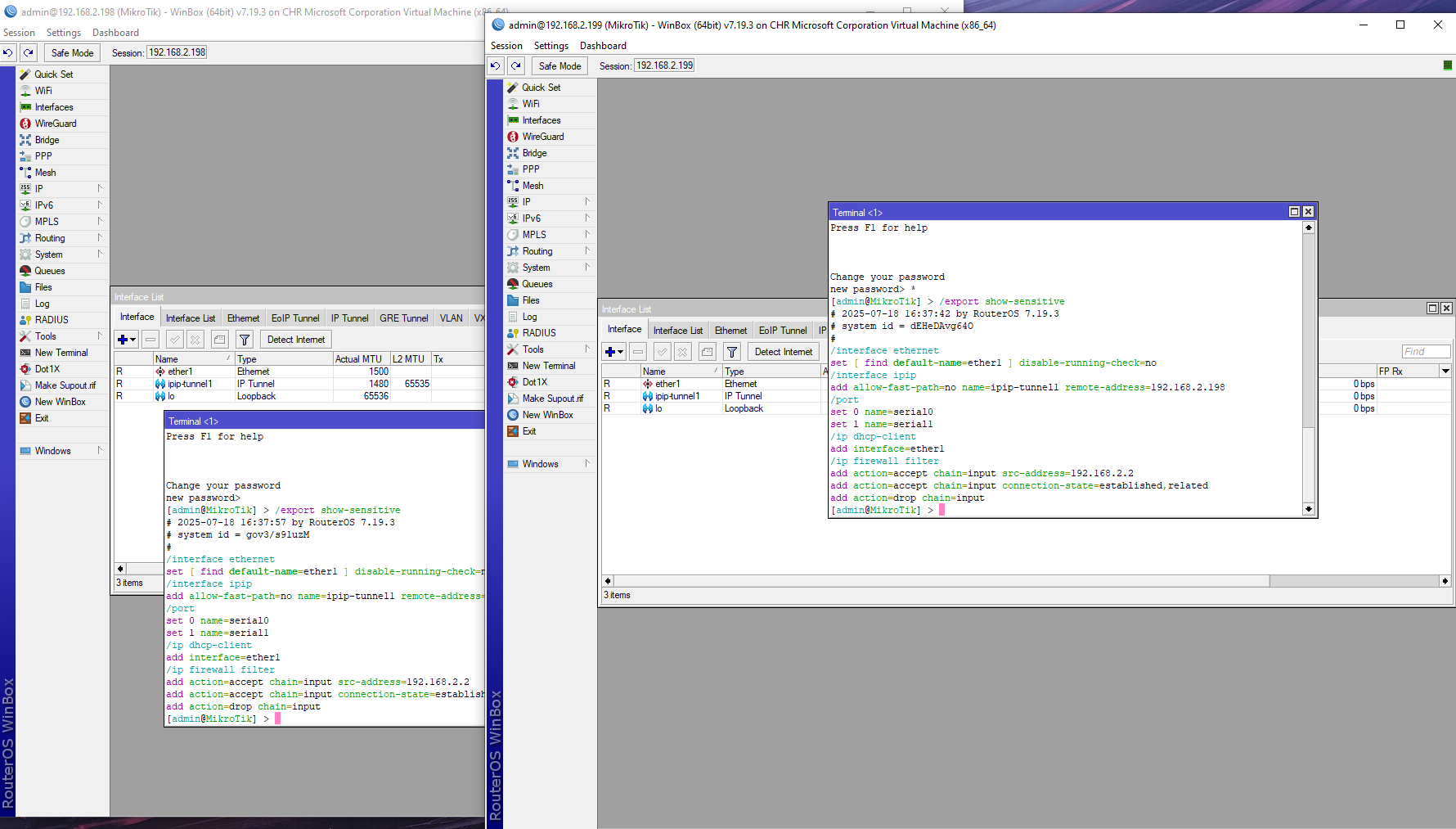

here is a quick example from two chr
Summary
Because it works for me.
I have no established ipip connections:
[admin@xxx] > /ip firewall connection print where protocol=4
(nothing)
I have an established/related rule followed by a drop protocol 4:
15    ;;; established
      chain=input action=accept connection-state=established,related log=no log-prefix=""
16    ;;; drop proto 4
      chain=input action=drop protocol=ipencap log=no log-prefix=""
The remote side is configured with a 10s keepalive. Counters are increasing:
[admin@xxx] > :put [ /ip firewall filter get 16 packets ]
0
(...about a minute later...)
4
The ipip interface on the remote end is shown as not running:
[admin@xxx2] > /interface/ipip/print proplist=name,running
Columns: NAME, RUNNING
# NAME          RUNNING
0 ipip-tunnel1  no

Well, there’s always a chance I’m wrong. I think it’s fairly clear that a keepalive is sent every 10s, and the keepalives are dropped.
The example you’ve screenshotted with the CHRs will obviously not work. This is because both sides are configured for keepalive by default. This means that both sides send keepalives to each other.
When an initial keepalive is sent, it’s state is “new”. This packet is not filtered in the output chain of the router sending it, so a conntrack entry is created. (Of course it’s filtered on the other end’s input chain.) But the other end also sends keepalives, which results in the conntrack entry being created ultimately on both ends.
This is why if you look at the list of connections (as suggested), you will find an IPIP connection to the other side in the “established” state, and why the firewall accordingly allows it.
