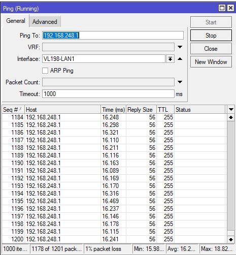

Now, a computer still cannot reach a LAN behind the IPSEC TUNNEL ; but when i’M using the “ping tool” directly on the router by specifying the source address AND the interface (lan for example) ; it works.
How is that even possible ?
And how can I make it work for the computer to reach the lan ?
