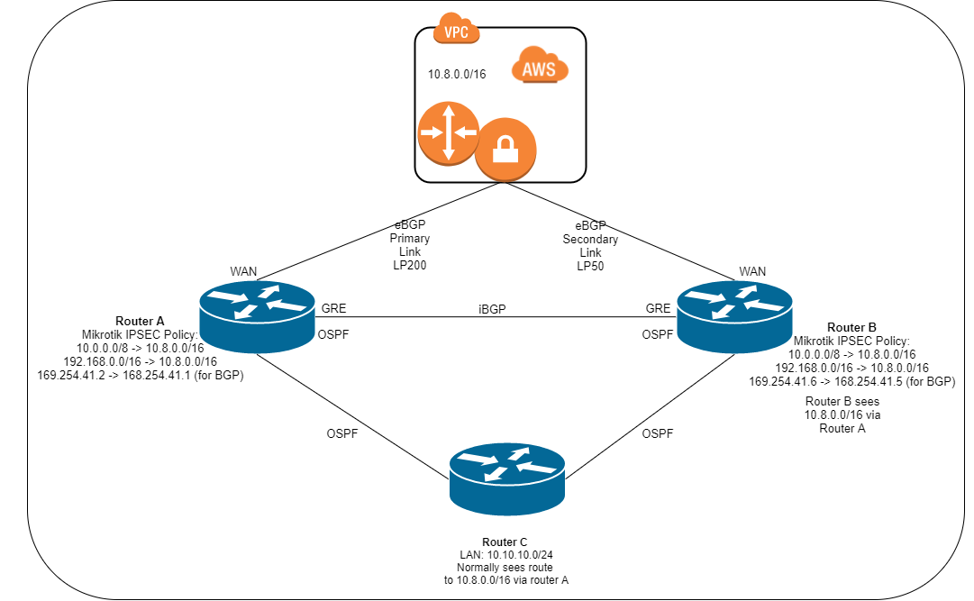

I have problem with IPSEC and routing towards AWS.
I have setup like in attached picture: two routers connected via IPSEC to AWS and third router below. Dynamic routing on AWS links is used. Link from Router A to AWS should be primary and from Router B is backup link.
All is good but when link from Router C to Router A goes down, Router C starts to forward traffic to 10.8.0.0/16 via router B and problem starts. Communication is broken and no connection to AWS. It looks like Router B starts to encrypt traffic from 10.10.10.0/24 to 10.8.0.0/16 according to IPSEC Policy, but it sends out this encrypted traffic via GRE interface to Router A because routing table have route from router A about network 10.8.0.0/16.
And yes, when I disable encryption policy on Router B everything starts to work, but that is not a solution, because I need redundancy with two links.

mducharme thanks for suggestion, but that will not work, as that brakes the redundancy. I don’t need static IPSEC links, I need redundant routed connection. Routing is actually working as it should, the problem is with encryption. Traffic needs to be encrypted only when it leaves WAN interface and not on GRE interface.

Created script on Router A and Router B which disables AWS related IPSEC policy on router if AWS networks in routing table are coming from GRE interface and enables policy if route is not seen from GRE
I’m on thin ice here too, because I don’t know much about BGP and don’t know if it changes something. But once the original packet to 10.8.x.x gets encrypted, destination of ESP packet is no longer 10.8.x.x, but whatever is in policy’s sa-dst-address, and it should be reachable via Router B’s WAN, shouldn’t it?
