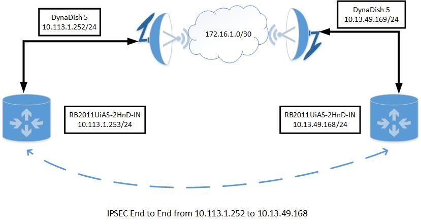

We have established a wireless link between two buildings (range 600m) using Mikrotik Dynadish 5 over 802.11ac protocol. These two ends (Dynadish 5) are wired connected with two corresponding Mikrotik routers (RB2011UiAS-2HnD-IN and RB2011UiAS-RM). We have access to each subnet behind RB2011UiAS-2HnD-IN and RB2011UiAS-RM and when we test with bandwidth tester iperf, we have almost ideal symmetric bandwidth results (approximately 250Mbps in TCP testing for each direction).
in the next step we establish an IPSEC tunnel between the two RB2011UiAS-2HnD-IN and RB2011UiAS-RM through the wireless link. Please see below the settings for each side of the IPSEC tunnel.

The IPSEC is established from one end (RB2011UiAS-2HnD-IN) to the other end (RB2011UiAS-RM) through the wireless link between the two Dynadish 5. We are really troubled since we obtain bandwidth results completely asymmetric. From one end to the other we obtain approximately 140-150Mbps, but when we test the opposite direction we obtain results approximately in the range of 10-15Mbps. All bandwidth tests take place with 2 PCs in the two corresponding subnets. From one side of the link, Dynadish and RB2011UiAS-RM are upgraded to the latest RouterOS version (6.37.1) but from the other side we have the previous version (6.36).

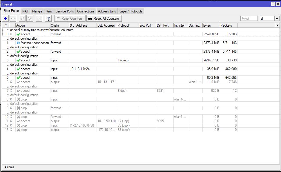

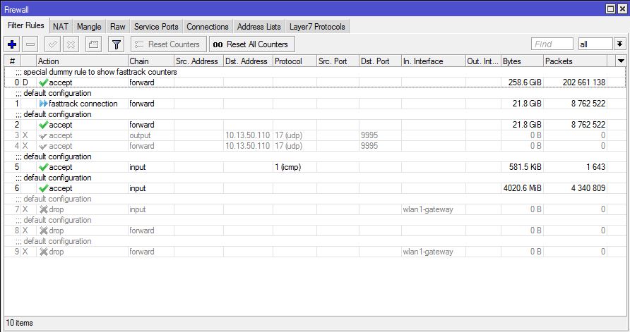

As we understand, there seems to be a firewall fasttrack issue because when we enable fasttrack from one side and disable from the other, the results are opposite but still highly asymmetric.
