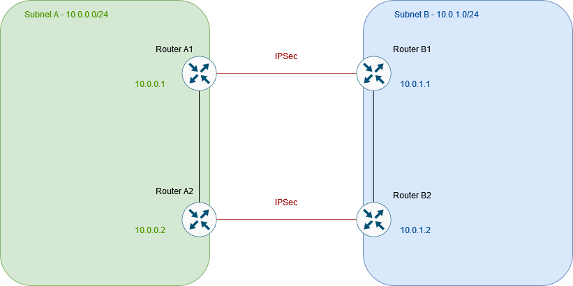

I’ve got a wierd scenario, which calls for a wierd setup and I’m having some trouble. I’m not sure if what I’m attempting is impossible, or if it’s just the implementation.
I’ve tried to simplify this as much as possible.
In the scenario above, there is an IPSec tunnel configured between routers A1 and B1 and another IPSec tunnel between A2 and B2.
Having performed test PINGs for this environment, I’ve essentially found that I can pass traffic between the devices that are explicitly connected via an IPSec tunnel, but I cannot ping devices which are not directly connected. For example:
Pinging 10.0.0.1 → 10.0.1.1 works.
Pinging 10.0.0.1 → 10.0.1.2 doesn’t work.
I’ve performed tracing and found that the ICMP request is correctly passed from router A1, over the IPSec tunnel to B1 and then over the xconnect to B2, but B2 doesn’t generate an ICMP response. I’ve used both packet captures and firewall logging on the input and output chains to come to this conclusion.
Does IPSec on RouterOS forcibly apply some kind of connection tracking/enforcement?

The IPsec standard requires that packets which reverse-match the traffic selector of any existing IPsec policy and did not arrive via the SA associated to that policy be dropped. So RouterOS silently drops them before they reach any firewall rule.

The thing is, the input packet does hit the firewall. If I create a filter rule on the input chain with an action of “log” I can see the packet come into the router.
If I modify the rule to apply to the output chain though, I see that no response is generated.
