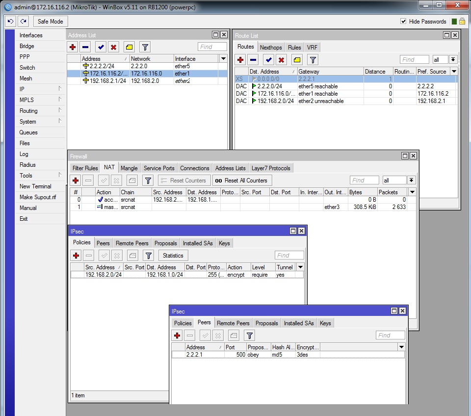

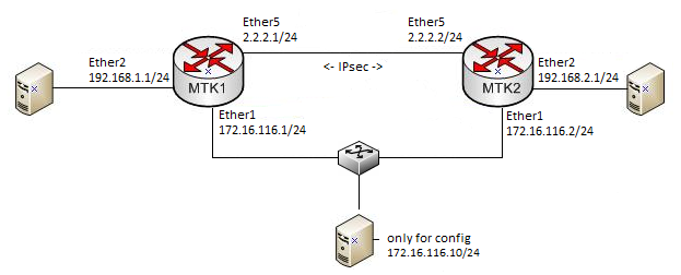

I have tried to make an IPsec tunnel between two RB1200 but it does not work. I can only reach the other RB 192.168.x.x network when I add a route. I have no “installed SAs”.
What is wrong in my config.?
I haven’t connected any device to the ether 2 ports. but i should be able to ping them when IPsec is working?
In my scenario it’s the same. routers can’t ping, but the networks behind are working well.
I’m not the IPSEC profi to tell you where the problem is and how you can solve it, but it’s working from the networks 192.168.1.0/24 and 192.168.2.0/24.
I have tried it with one notebook on each 192.168.x.x network but it also doesn’t work.
Try to find your misconfiguration by using this PDF: http://gregsowell.com/wp-content/uploads/2009/12/GregSowell-mikrotik-vpn1.pdf
