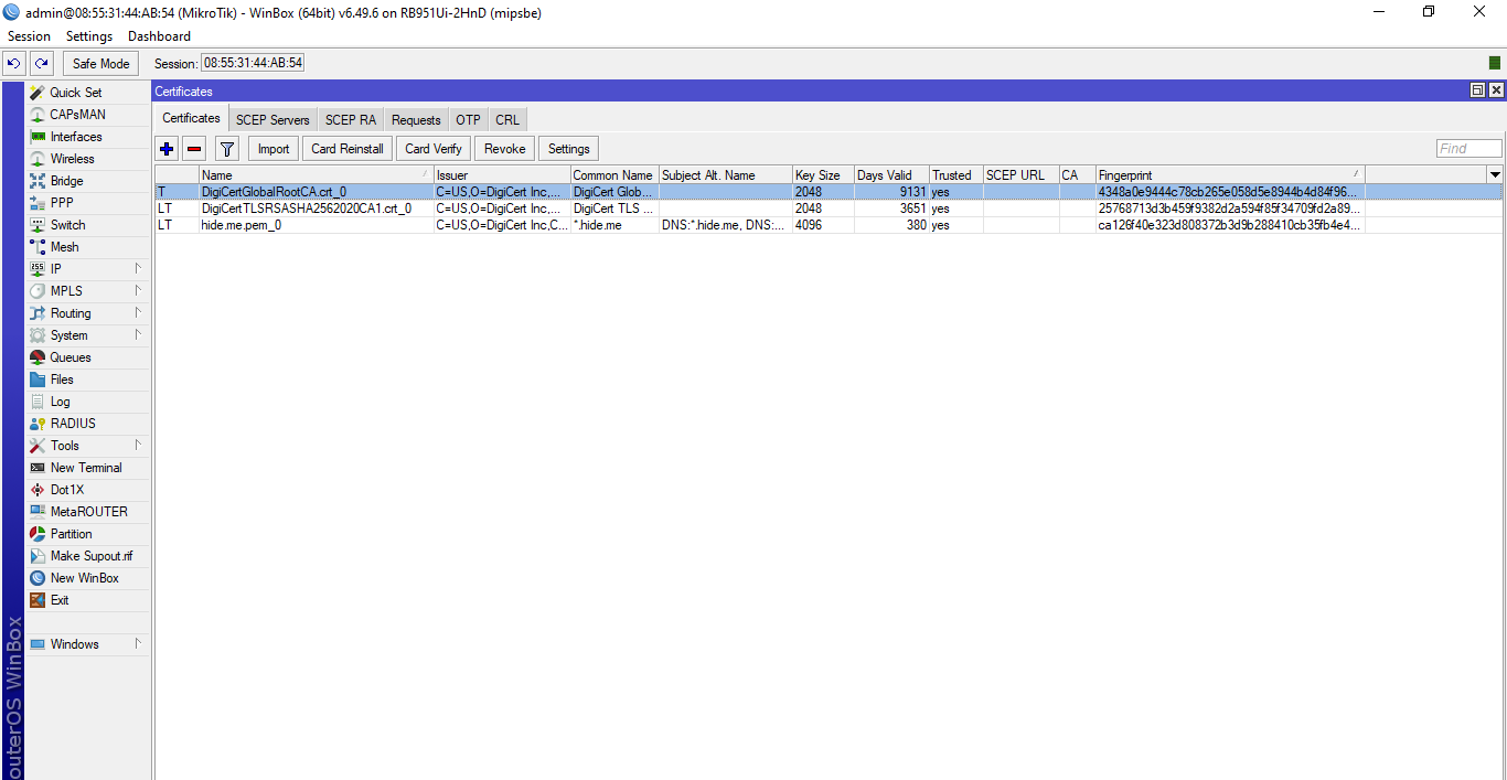

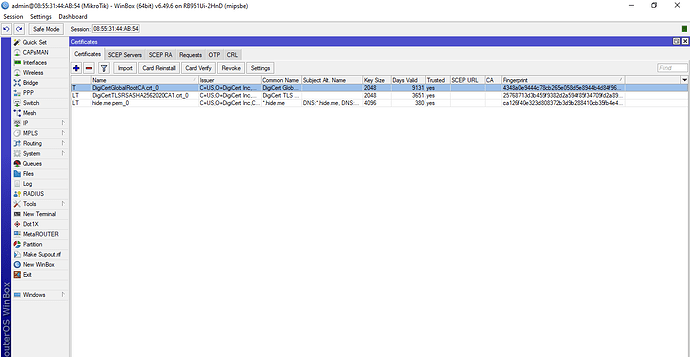

Something must have gone wrong, because the certificates you’ve installed are not marked with A(uthority) in the status column.
In the ‘Certificates’ section I don’t see an ‘Authority’ column; do you see anything abnormal in the picture attached?
