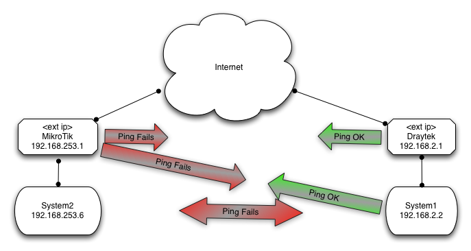

Picture to describe what’s working & what’s not… N.B. IPsec VPN comes up - pings at basic network level on ext-ip’s are fine - it’s just the VPN IP addresses that are failing.
