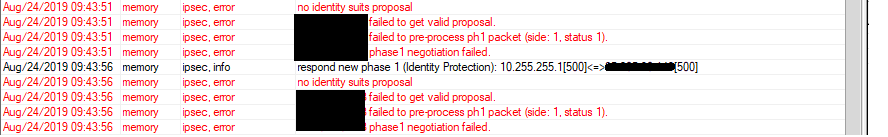

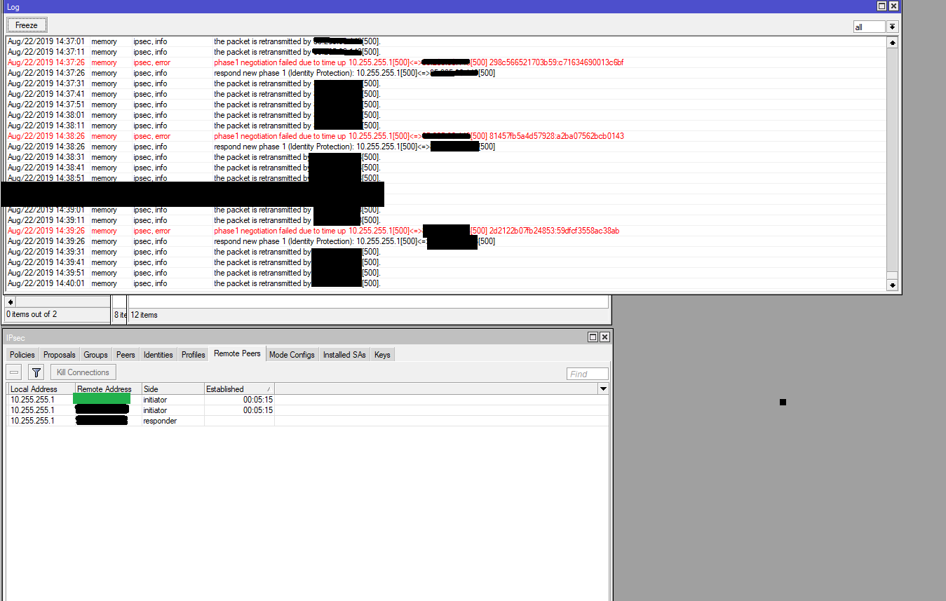

I have a weird “problem” with IPSec lately. The connection works fine but I can see in log that there are timeouts and also in remote peers I can see a second connection for the same tunnel but that one seems to be stuck.
There are two tunnels on this router and one is working fine, the other has this strange behaviour.
Has anyone had the same problem?
Thank you for your help
It won’t help you, but you’re not alone, I also see this on one router. I also have two tunnels with two different peers and only one does this. I don’t know when it started, but I first saw it happening on older RouterOS that worked fine before. I don’t remember exact version, I think something a little before 6.40, because somewhere around that MikroTik did bigger changes with IPSec and I rather hold back for a while. Now I have 6.44.5 and it’s the same.
It’s probably something on the other end, either bug or misconfiguration. Unfortunately in my case, the other end is not under my control. I don’t even have any idea what’s running there, most likely some big brand device. As long as it doesn’t break down completely, the chance to get any useful info from the other party is very low. And it’s not something I can play with much, it must keep running.
Try to enable more verbose logging, maybe it will show something useful. Or maybe not, the only unusual line I see is “SPI size isn’t zero, but IKE proposal”, but it doesn’t really tell me much.
It can be caused by weird bugs in other router’s NAT implementation.
E.g. when the MikroTik router is behind an AVM FritzBox or a Draytek router operating in NAT mode this kind of behaviour can often be observed.
It can help to take the connection down for at least as long as that router needs to flush its NAT table, or to reboot that router.
It is possible that both sides try to establish a connection simultaneously. You can see in the screenshot that one peer is initiator and one responder. You can use passive=yes on one side to make sure it does not initiate a connection. Having two active sessions between the same devices should not introduce any issues because the peers will negotiate themselves which IPsec SAs to use.
The second (responder) peer does not establish probably because of a strict firewall preventing new UDP/500 connections to establish in router’s input chain. The initiator peer works because the connection is initiated by the router itself and all responses are accepted by router’s “accept established” rule in input chain.
Before OP returns with some more info, I can say that firewall problem is unlikely in my case.
When my router is initiator, it works, so remote peer must accept new connections. The problem occurs when remote peer is initiator, but since the packet arrived to my router and IPSec sees it, my firewall clearly doesn’t block it either. And I also know for sure that I accept udp/500.

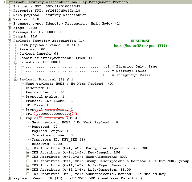

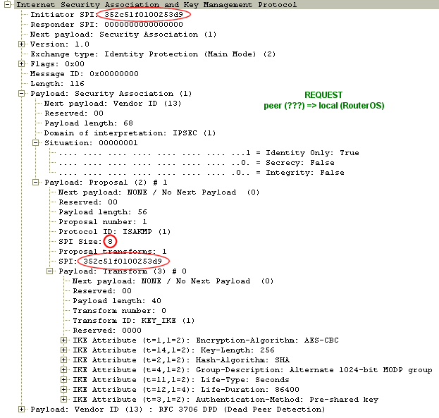

I’m wondering it it may have something to do with that “SPI size isn’t zero, but IKE proposal” message. I found what it’s about. With all other tunnels I have, field “SPI size” in incoming proposal is always zero (also for outgoing ones). With this one it’s 8 and then there’s SPI from initiator. When RouterOS responds, it also sets SPI size to 8, but then SPI is all zeroes. I don’t know if it’s correct or not (I looked in RFC, but I didn’t come across any easy to find answer there), but it’s the only difference I see, when compared to other tunnels.

Here is log with the above logging setting.
I dont see anything interesing there though, It almost looks like config mismatch, but in the log the setting is correct on both sides.

14:17:59 ipsec,debug hash(sha1)
14:17:59 ipsec,debug type=Group Description, flag=0x8000, lorv=1536-bit MODP group
14:17:59 ipsec,debug dh(modp1536)
14:17:59 ipsec,debug type=Life Type, flag=0x8000, lorv=seconds
14:17:59 ipsec,debug type=Life Duration, flag=0x0000, lorv=4
14:17:59 ipsec,debug type=Authentication Method, flag=0x8000, lorv=pre-shared key
14:17:59 ipsec,debug pair 1:
14:17:59 ipsec,debug 0x8101298: next=(nil) tnext=(nil)
14:17:59 ipsec,debug proposal #1: 1 transform
14:17:59 ipsec,debug -checking with pre-shared key auth-
14:17:59 ipsec,debug prop#=1, prot-id=ISAKMP, spi-size=8, #trns=1
14:17:59 ipsec,debug trns#=0, trns-id=IKE
14:17:59 ipsec,debug type=Encryption Algorithm, flag=0x8000, lorv=AES-CBC
14:17:59 ipsec,debug type=Key Length, flag=0x8000, lorv=256
14:17:59 ipsec,debug type=Hash Algorithm, flag=0x8000, lorv=SHA
14:17:59 ipsec,debug -compare proposal #1: Local:Peer
14:17:59 ipsec,debug (lifetime = 86400:86400)
14:17:59 ipsec,debug (lifebyte = 0:0)
14:17:59 ipsec,debug enctype = AES-CBC:AES-CBC
14:17:59 ipsec,debug (encklen = 256:256)
14:17:59 ipsec,debug hashtype = SHA:SHA
14:17:59 ipsec,debug authmethod = pre-shared key:pre-shared key
14:17:59 ipsec,debug dh_group = 1536-bit MODP group:1536-bit MODP group
14:17:59 ipsec,error no identity suits proposal
14:17:59 ipsec,error XXX.XXX.XXX.XXX failed to get valid proposal.
14:17:59 ipsec,error XXX.XXX.XXX.XXX failed to pre-process ph1 packet (side: 1, stat
us 1).
14:17:59 ipsec,error XXX.XXX.XXX.XXX phase1 negotiation failed.
14:18:01 system,info ipsec peer peer2 changed by admin
14:18:01 ipsec,debug ===
14:18:01 ipsec,info initiate new phase 1 (Identity Protection): 10.255.255.1[500]<
=>XXX.XXX.XXX.XXX[500]
14:18:01 ipsec,debug new cookie:
14:18:01 ipsec,debug 3dadeca0fe173faa\01
14:18:01 ipsec,debug add payload of len 56, next type 13
14:18:01 ipsec,debug add payload of len 16, next type 13
14:18:01 ipsec,debug add payload of len 16, next type 0
14:18:01 ipsec,debug 348 bytes from 10.255.255.1[500] to XXX.XXX.XXX.XXX[500]
14:18:01 ipsec,debug 1 times of 348 bytes message will be sent to XXX.XXX.XXX.XXX[50
0]
14:18:01 ipsec sent phase1 packet 10.255.255.1[500]<=>XXX.XXX.XXX.XXX[500] 3dadeca0f
e173faa:0000000000000000
14:18:01 ipsec,debug ===== received 108 bytes from XXX.XXX.XXX.XXX[500] to 10.255.25
5.1[500]
14:18:01 ipsec,debug begin.
14:18:01 ipsec,debug seen nptype=1(sa) len=60
14:18:01 ipsec,debug seen nptype=13(vid) len=20
14:18:01 ipsec,debug succeed.

14:18:03 ipsec SPI size isn’t zero, but IKE proposal.

Is this all from one peer? I see four parts (by starting time):
14:17:54 - incoming phase 1, fails with “no identity suits proposal”
14:17:59 - same as previous
14:18:01 - outgoing phase 1 & 2, succeeds
14:18:03 - incoming phase 1, authentication succeeds, router sends response, but peer resends the request, as if it didn’t get the response
Interesting difference between #1 and #4 is that the former has only DPD, while the latter has more vendor IDs. I’m no IPSec expert, so I don’t know if it’s possible that same peer would sometimes send more or less of them, or if you have logs from two peers mixed together.
If I take only #4, then it’s the same as what I’m seeing, both peers seem to agree on proposal, but it’s like remote one doesn’t receive the response. But since there’s no reason why it wouldn’t receive it (if it’s initiator, then the response must be allowed by its “accept established” in firewall), maybe it does receive it, but doesn’t like it for some reason?
I guess it could be the difference between the peer acting as an initiator and acting as a responder. As I wrote, I have sometimes seen that peers did not meet because of the NAT inbetween, causing the traffic in one direction not to meet the traffic in the other direction, and those “the packet is retransmitted” messages to occur.
But maybe in this case it is completely different…
