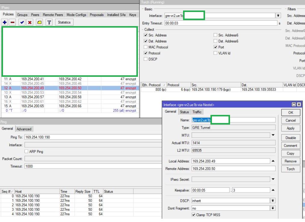

The device on the far side indicated both ph1 and ph2 up. Bizarrely even though the policy on the Mikrotik is marked as invalid and clearly indicated as not established, the GRE interface is in a running state and the BGP neighbor connected. So this seems to me that even tough the policy is marked as invalid in the UI as well as the terminal, somewhere, somehow a valid policy is still installed. When I enable and disable the peer, the ph1 reestablished immediately but ph2 does not reestablish and obviously the BGP neighbor now looses comms as the GRE is not in a running state. No matter what I do, I cannot force the policy into a valid state again - after x hours, it just magically recovers. Diagnostic logs indicate: ipsec,debug no policy found for id:11473.
I quite urgently need to get this resolved - again, any assistance would be greatly appreciated.
Below the invalid policy with traffic flowing correctly as if the tunnel is working 100% (prior to resetting the peer):

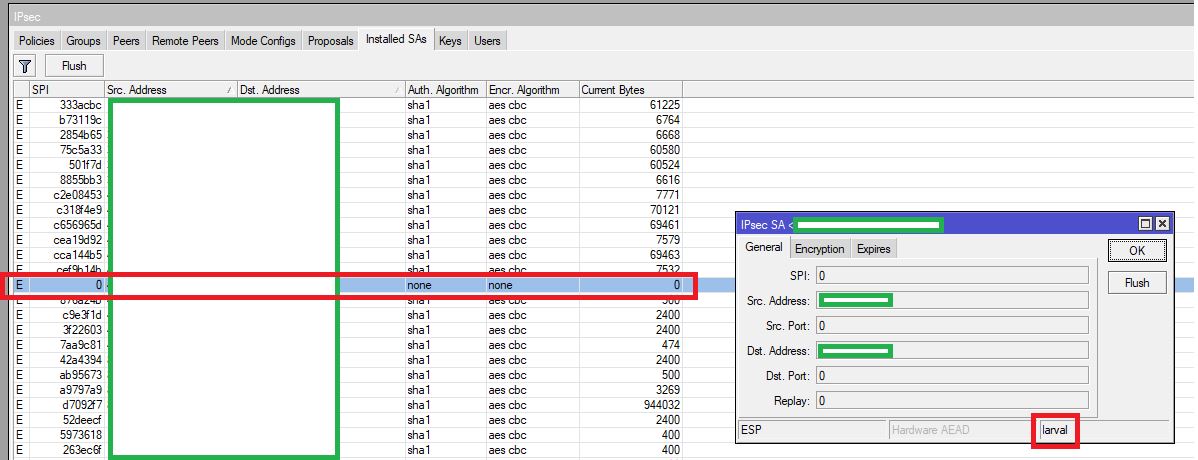

Please show me also the output of /ip ipsec policy print and /ip ipsec installed-sa print when it runs but the policy is marked as inactive. The encryption and authentication keys shown in the installed-sa printouts are temporary ones so no need to edit them out, it is enough to wait up to 30 minutes before posting them.
Once more thank you for the reply. Below the output of the peer and sa status. I have also attached the log, obfuscated the IPs as per the config provided and marked non-relevant IPs as x.x.x.x.

Installed SAs
# apr/17/2019 14:54:26 by RouterOS 6.42.6
# software id = PFRD-4CSN
Flags: H - hw-aead, A - AH, E - ESP

 4  E spi=0 src-address=11.0.0.11 dst-address=33.0.0.33 state=larval
      add-lifetime=0s/30s replay=0

SyslogCatchAll-2019-04-17 obfuscated.txt (511 KB)
My personal opinion is that has nothing to do with configuration. None of your other policies can shadow the one mysteriously going inactive, even if we’d admit that the order of the policies wouldn’t matter. It normally does but when you add a new policy this used to fail in older ROS releases, e.g. on the 6.43.8 where I’ve just tested it.
So it is either a bug or, if the other Routerboard/CHR /x86 on which you’ve never seen the issue to happen is the same model like the problematic one, there can be a hardware (RAM) issue on the problematic one.
So you may try the following steps and hope that one of them works around the bug (the last one may “fix” rather than “workaround” it although none of the changelog items listed below is guaranteed to be related):
  • separate the addresses used to send for the GRE transport (to be matched by the IPsec policy) from the addresses attached to the GRE interface, at least on Mikrotik side, the way I’ve suggested above; doing so will allow you to remove the protocol=gre from the traffic selector of the /ip ipsec policy
  • set the sa-src-address of the policy to 0.0.0.0. It may make things better (the policy won’t jump inactive) or worse (it won’t ever come up), the idea is just to force a different branch of the algorithm, not something precisely targeted to a known issue
  • set the level to unique instead of the current require - same motivation like above
  • upgrade to 6.43.12 (the last available one before 6.44 - to keep the structure of IPsec configuration you are used to)
The following items in the changelog may be related:
  • 6.42.7: *) ipsec - improved invalid policy handling when a valid policy is uninstalled;
  • 6.43:
    • *) ike2 - fixed initiator first policy selection;
    • *) ipsec - improved invalid policy handling when a valid policy is uninstalled;
    • *) ipsec - improved reliability on generated policy addition when IKEv1 or IKEv2 used;
The “improved invalid policy handling when a valid policy is uninstalled” is mentioned also in 6.44 changelog, so it seems to be a complex issue.
Thank you very much for your time sindy, I will update this thread with the findings.
Update:
I have:
  • changed the policy level to unique. This unfortunately did not resolve the issue.
  • moved the IP addresses used to match the IPSec policy to a loopback adapter (bridge) and away from the GRE interface. This unfortunately did not resolve the issue.
  • Upgraded to v6.43.16. The issue however remains
One thing that I have been able to achieve is forcing the policy out of the invalid state. This is achieved by changing the protocol to something else - e.g. all. Changing it back to protocol 47, immediately puts it back into an invalid state. Even if the protocol is set to all, not 47, it still randomly goes into an invalid state (and some hours later, fixes itself, and the process repeats).
I will update Mikrotik support with the findings.
