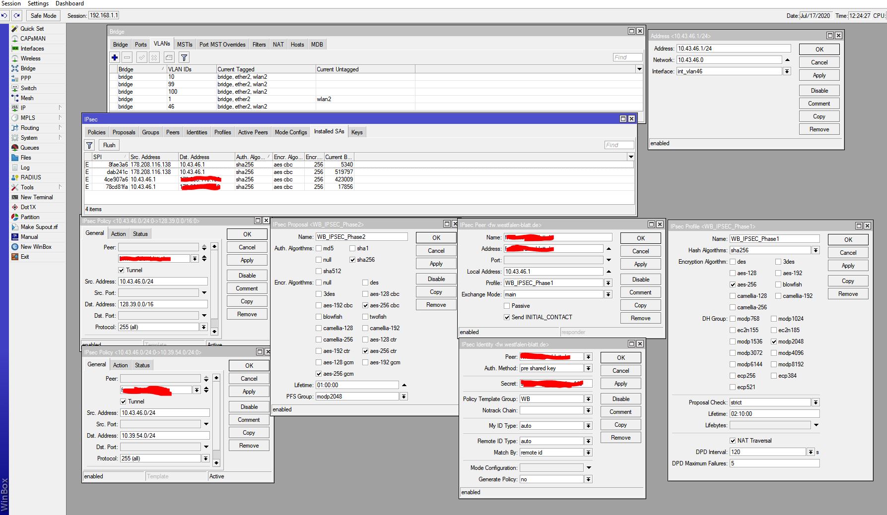

Hello, i have configure a ipsec tunnel from MT to Sophos UTM.
1 tunnel works.
But if I activate a 2nd tunnel SA, the first SA no longer works.
Both connections are shown to me as established in Mikrotik.
The same setup works fine with a Draytek router.
The local Network in Sophos location for the 1. SA is 128.39.0.0/16 and the 2. SA is 10.39.54.0/24
The Mikrotik Network for the IPSEC Network is an vlan 46 in a bridge with Networkaddress 10.43.46.0/24

Hi, the support helps me.
The solution for the problem with more then 1 SA is to change in the Policy on Tab Action the level from require to unique, see screenshot.
