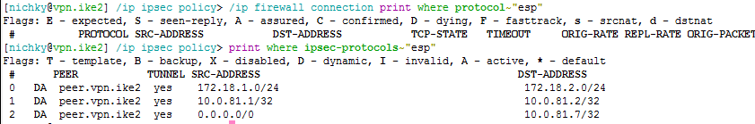

in my case i can’t see ESP in the connection tracking , not sure why

Two possible explanations come to my mind:
  • there is NAT at at least one end and therefore the ESP gets encapsulated into UDP
  • you use protocol=esp in the search condition whilst the RouterOS name is ipsec-esp.

maybe is not good idea for me to jump here. Because you have replayed on my one. This router is behind NAT, and im using in only for VPN
same as here
Well, the OP’s issue has been resolved and I’ve commented on it too, so hopefully your piggy-back is not so disturbing.
The ipsec-protocol as a parameter of policy can be ah or esp. The protocol as a parameter in /ip firewall can be ipsec-ah or ipsec-esp. As you use matching using regexp (~“esp”), you would see the connection in the firewall if it was there.
Since there is NAT, there is nothing to think about, but you can use /ip ipsec installed-sa print, you should see src-address=a.a.a.a:ppp, meaning that the ESP (which doesn notion of ports) is encapsulated into UDP. If it was bare ESP, the “:ppp” part would be missing in src-address and dst-address. The firewall doesn’t look into UDP payload to find out whether it is not ESP by chance.
