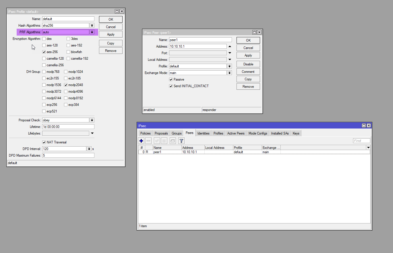

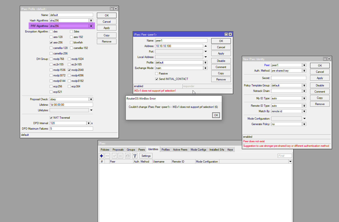

The IPSec configuration give me an error:
could not add IPsec policy: IKEv1 does not support prf selection! (6)
I have no idea where to start looking.
An error occurs during configuration. None peer conected.
Any idea?

for those looking for a simple search who aren’t logged in and therefore can’t see the png files – the exchange mode needs to be IKE2 on the peer (versus main/etc)
