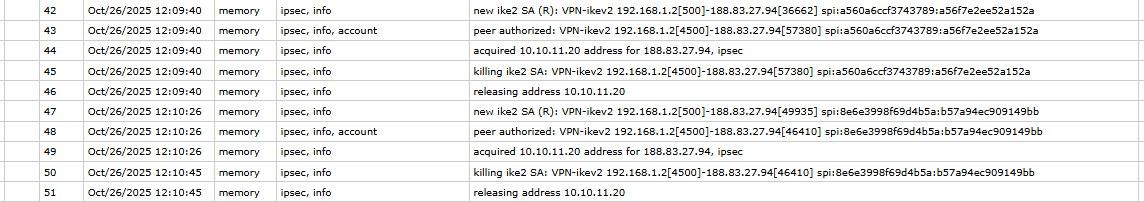

well i am no expert… so it hard for me to understand certain results. I ve placed on logging , “topics ipsec and prefix ipsec”. The result i had trying to enter from android 15 equipment (Redmi pad 2) was the following:
i ve connected with android 14 equipment (samsung a13) , all in above picture is the same (although different value of identifier, and it works perfect.
what am i missing?! i ve already check configurations both on mikrotik and the 2 android equipment and all is equal!

i ´ve resolved my case using what’s written on this post: “https://forum.mikrotik.com/t/getting-ipev2-ipsec-psk-mikrotik-android-13-vpns-working-and-maybe-other-key-sharing-methods-too/169573/4”.
Somhow android 15 does not like the identities “My ID type” field as “auto” but changing my ID type to “fdqn” and My ID to “server DNS name”. Also on the equipment it requres identiifier as”server DNS name”, equal to server name, and it connects. Android 14 on the opposite, does not accept that and it should maintain My ID type to “auto” because does not connect otherwise. Hope it helps… Thanks ans Regards
