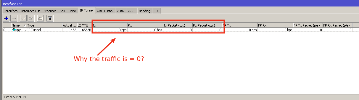

Hi guys,
I have a question about IP tunnel interface. I have IPSec tunnel between Mikrotik and Cisco ASA, all work finely. But in the “Interfeces” - “IP Tunnel”, my virtual interface have colums “Tx”"Rx""TX Packet""RX Paket" etc. = 0. Why?
I tried to creat new firewall rule that logging all traffic from virtual IP Tunnel, but I not see lines in the “Log”. Why?

What do you have, an IPsec tunnel or an IPIP tunnel?
Please show your configuration.

PS. Also I found such a thing. When I do “disable IP-IP interface” relationship between networks remains, that is, the pings don’t stop.
I have a feeling that virtual interface and the ipsec live separately.
That is correct, you have made two tunnels that are completely independent and have no relation, and traffic is flowing over the IPsec tunnel.
You can delete the IPIP tunnel, it is not required for this configuration.
