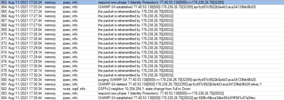

I have Ipsec connection: Juniper → Mikrotik CCR1009-7G-1C-1S+. Juniper act as client and Mikrotik act as responder. All works fine. But every time when ipsec proposal lifetime come to the end (about 27 minutes), the tunnel breaks. And after 10 second it comming up.
What i can see in the logs:
I have another tunnels between this Juniper and other Mikrotik models with same settings, and there are no such problems. The only differences are mikrotik router model and firmware.
