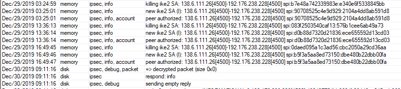

Nothing special in the log:

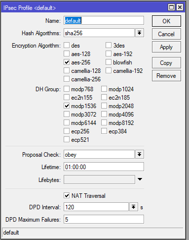

Peer settings:
