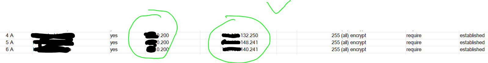

I have P2P Ipsec connection and added with 3 x policy from one subnet to different subsets (in pic) and PH2 is all establish with the same p2p ipsec tunnel and it works.
I did not found any information if i can use like that. Tried to find in official manual (maybe did not see :frowning: ), but there are no explanation if i can use like that. Every example is one subnet to one subnet and thats it. Can someone explain little about ?

Tested with with IPSEC tunnel with multiple policy (aka selectors traffic picture up) it works.
But Sindy mention this is not the best solution to do this. So my question is what is then best solution to fulfill this requirements on MK.
