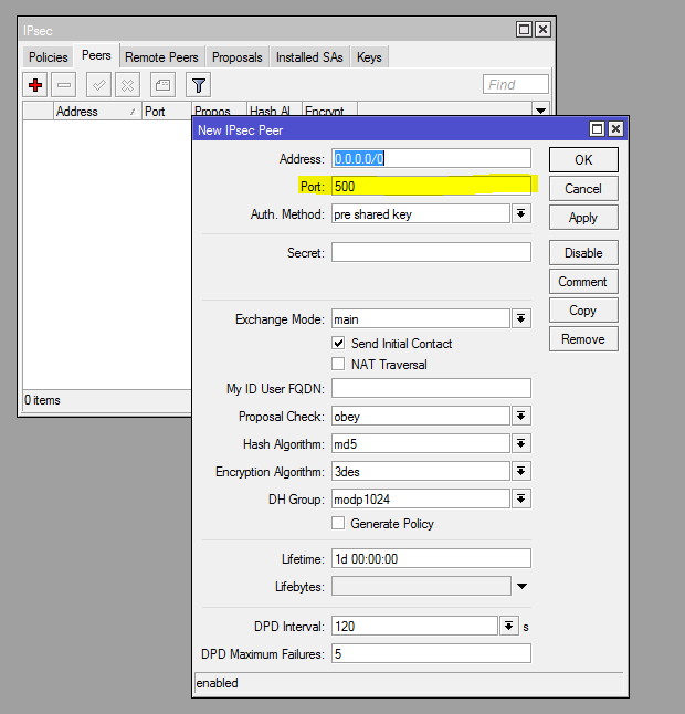

I really am curious what is the use of ‘port’ in the following!

The port in the peer settings it the one at which you expect the remote peer to listen. It is not possible to change local port where the peer listens, but you may use dst-nat and src-nat rules to redirect it.
