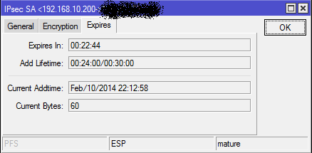

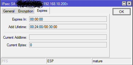

I’m trying to create an ipsec vpn tunnel between a Mikrotik and a cisco router.
It seems that the SPI SA in the direction Mikrotik → Cisco is installed fine but the
SPI SA in direction Cisco → Mikrotik is not installed (there is no addtime).
[admin@MikroTik] /ip ipsec installed-sa>> print
Flags: A - AH, E - ESP, P - pfs
0 E spi=0x382B108 src-address=192.168.10.200 dst
auth-algorithm=md5 enc-algorithm=3des replay
auth-key=“adc4c7acfdbf86e3a9750c0e0a81f569”
enc-key="d3e54e4f122fc8920e651aec4157afd887b
addtime=feb/10/2014 22:12:58 expires-in=27m5
current-bytes=60
1 E spi=0xF778A1E src-address=190.X.X.X dst
auth-key=“448e14a463e062902f5d70507b1dbbcb”
enc-key="74309e284428767f831c42f833544d147b7
add-lifetime=24m/30m
