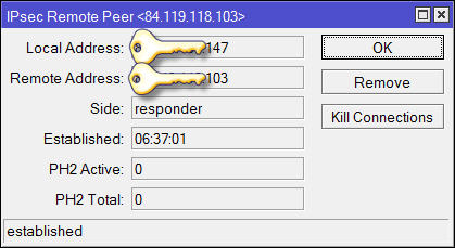

Remote Peers tells:
Connection 1.1.1.1 → 1.1.1.2 is Established since 2 hours, PH2 Active 0, PH2 Total 0.

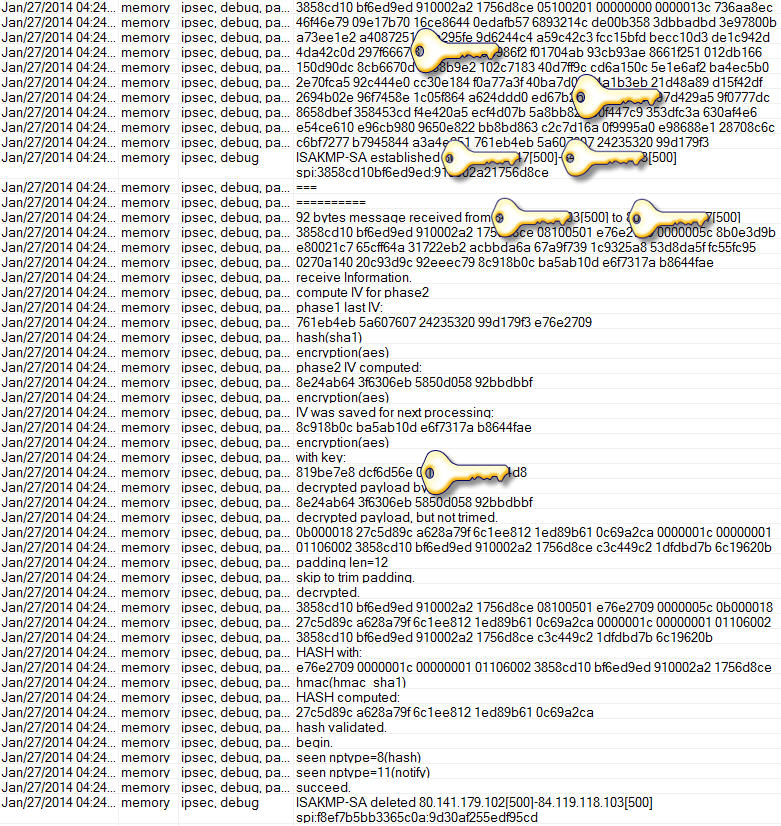

Log tells me:
ISAKMP-SA established
1.1.1.1:500 ↔ 1.1.1.2:500
spi: 8dfe************daa8
DPD-R-U-There Packets are sent each 60s and gets Ack vice-versa.

I’ve made a new ScreenShot, maybe my information was not enough for debug.
Can someone help me, please?
Okay solved right now.
It was that stupid kind of testing error :laughing:
Proposals only gets active when according traffic is being sent.
