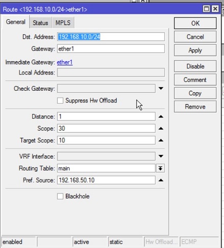

This is the routing on the CHR Mikrotik (ether1 is the public ip interface)

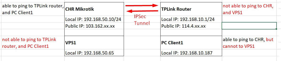

So far, this is what my progress. I also can ping from PCClient1 to CHR Mikrotik local IP.
Other than routing on Mikrotik CHR, there is no firewall / NAT setup on both of routers.

To the actual issue - the IPsec itself works, as you can ping through the tunnel to both the TP-link and the PC behind it. Since there is no firewall, what remains is routing between the VPS and the CHR and source address selection on the TP-link device.
You had to set pref-source of the route to 192.168.10.P/24 on the CHR to make the packets visible to the IPsec policy. But you haven’t mentioned doing the same on the TP-link, which most likely means that when you ping 192.168.50.10 from the TP-link, the TP-link uses its public IP (associated to the default gateway’s interface) as a source address for the ping requests, which means that its local IPsec policy misses those packets. For responses to incoming pings, the source address is the one to which the incoming requests arrive.
Is the CHR the default gateway for the VPS? If not, you have to add a route to 192.168.10.0/24 via 192.168.50.10 at the VPS, or to make the CHR src-nat the traffic from 192.168.50.0/24 it forwards to the VPS, so that the VPS would send the response traffic to CHR’s address.
