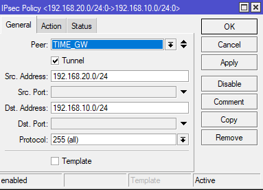

i have a problem in OS7
i have ipsec site to site with fortigate
tunnel is up phase one and phase2 , when i ping from fgt network to mikrotik network it works while when i ping from mikrotik network it goes through wan and get
[admin@MikroTik] > ping 192.168.10.17
SEQ HOST SIZE TTL TIME STATUS
0 xxx.112.90.49 84 55 18ms459us TTL exceeded
1 xxx.112.90.49 84 55 17ms51us TTL exceeded
2 xxx.112.90.49 84 55 18ms857us TTL exceeded
sent=3 received=0 packet-loss=100%
[admin@MikroTik] > ping 192.168.10.17 src-address=192.168.20.254
0 192.168.10.17 56 63 31ms182us
1 192.168.10.17 56 63 29ms919us
2 192.168.10.17 56 63 29ms932us
sent=3 received=3 packet-loss=0% min-rtt=29ms919us avg-rtt=30ms344us max-rtt=31ms182us
[admin@MikroTik] >

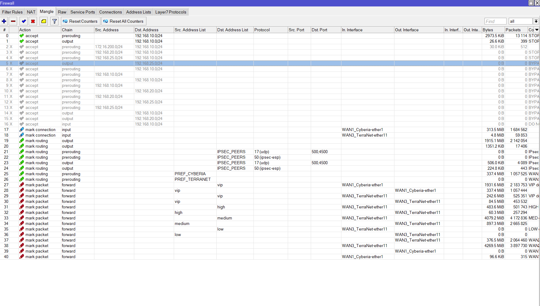

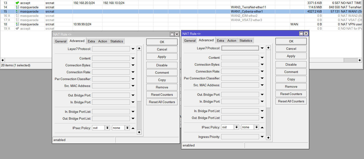

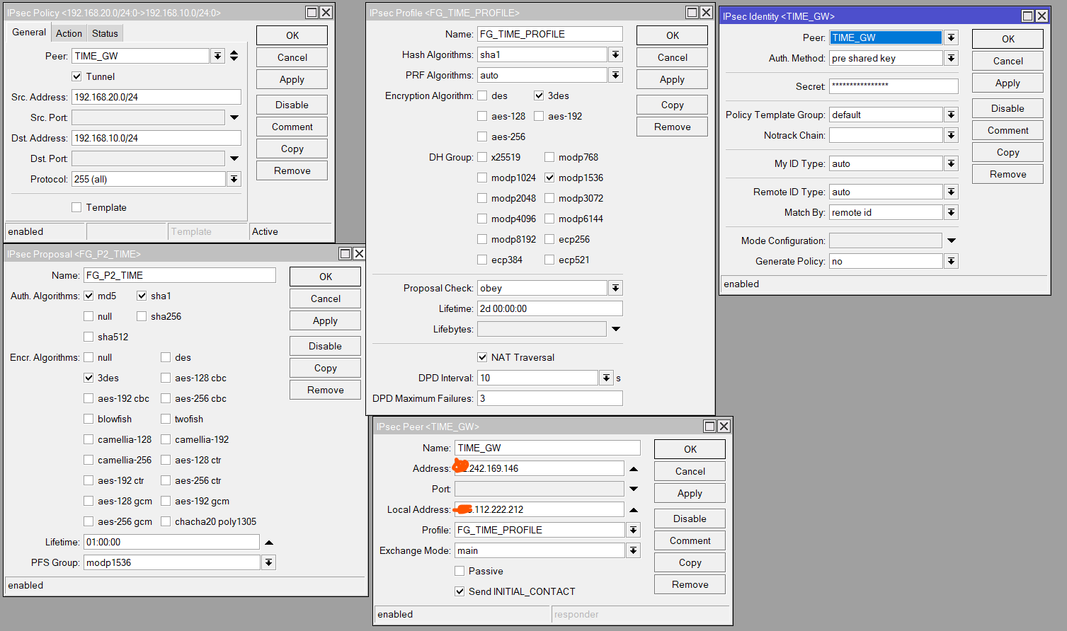

i set policy on mikrotik
I also tried to set ipsec out none in masquerade rule with no luck
Any chance i can make this vpn work?
thanks in advance

IPsec has some specific behavior - it matches packet headers against IPsec policy traffic selectors as the very last step before sending a packet via the out-interface chosen by normal routing.
And when the router itself sends a packet that is not a response, it only sets its source address after routing - routing finds the out interface and the packet gets the primary address of that interface as a source, unless a pref-src parameter of the route used indicates a different one.

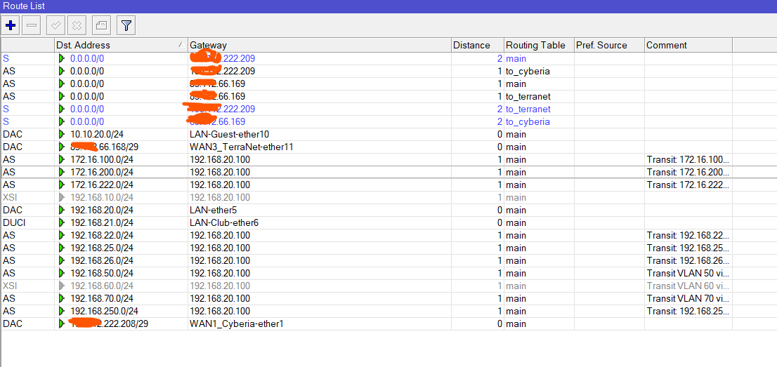

Your IPsec policy matches on src-address=192.168.20.0/24, but the default route most likely goes via the WAN interface so the packet gets the WAN IP as its source address, and hence it doesn’t match your policy. So if you only need pinging from the router for testing, specify src-address as a parameter of the ping, but make sure that src-nat or masquerade won’t change it - I don’t know your nat rules so they may or may not care about this. Transit traffic from connected devices in 192.168.20.0/24 will have an address that matches the policy, but you also have to make sure that src-nat or masquerade doesnt change it.
When you ping from the Forti side, the Mikrotik responds from the same address at which it has received the request and nat rules are only used to handle the initial packet of each connection, so even the exemption from src-nat is not necessary.

Thank you Sindy for you informative question,
I don’t care to ping from router but also when pinging from internal network behind Mikrotik to 192.168.10.0 network it will not work

If so, use /export hide-sensitive file=some-nice-name, then download some-nice-name.rsc, use your favourite text editor’s “find and replace” function to systematically replace the first two bytes of any public addresses with something like psub.a. (public subnet A), psub.b. etc. (to preserve consistency between addresses in the same subnet) and also obfuscate any usernames for 3rd party services, serial numbers, MAC addresses… as hide-sensitivedoesn’t hide everything, only passwords and private keys. Then copy-paste the the result to the post between two ` signs (or use the</>button).
But the way you describe it, the srcnat rules seem to be the most likely issue.

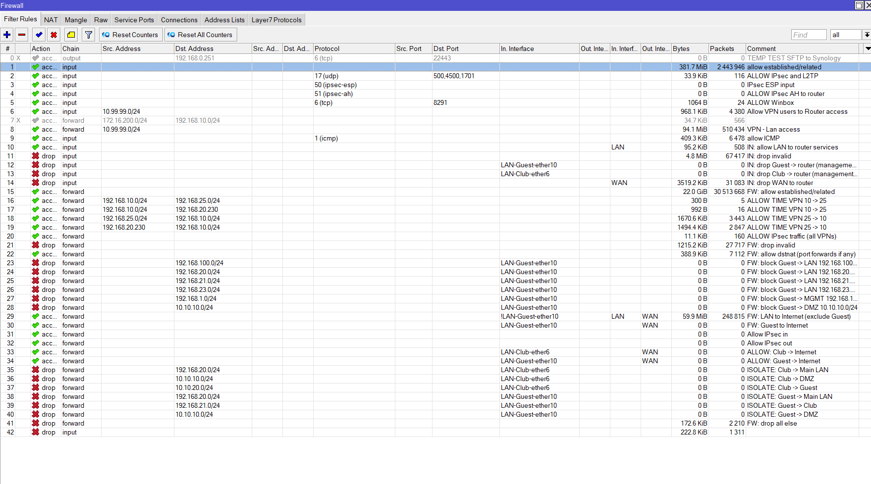

add action=accept chain=output comment="TEMP TEST SFTP to Synology" disabled=
yes dst-address=192.168.0.251 dst-port=22443 protocol=tcp
add action=accept chain=input comment="allow established/related"
add action=accept chain=input comment="ALLOW IPsec and L2TP" dst-port=
500,4500,1701 protocol=udp
add action=accept chain=input comment="IPsec ESP input" protocol=ipsec-esp
add action=accept chain=input comment="ALLOW IPsec AH to router" protocol=
ipsec-ah
add action=accept chain=input comment="ALLOW Winbox" dst-port=8291 protocol=
tcp
add action=accept chain=input comment="Allow VPN users to Router access"
src-address=10.99.99.0/24
add action=accept chain=forward disabled=yes dst-address=192.168.10.0/24
src-address=172.16.200.0/24
add action=accept chain=forward comment="VPN - Lan access" src-address=
10.99.99.0/24
add action=accept chain=input comment="allow ICMP" protocol=icmp
add action=accept chain=input comment="IN: allow LAN to router services"
in-interface-list=LAN
add action=drop chain=input comment="IN: drop invalid" connection-state=
invalid
"IN: drop Guest -> router (management plane)" in-interface=
LAN-Guest-ether10
"IN: drop Club -> router (management plane)" in-interface=LAN-Club-ether6
add action=drop chain=input comment="IN: drop WAN to router"
in-interface-list=WAN
add action=accept chain=forward comment="FW: allow established/related"
add action=accept chain=forward comment="ALLOW TIME VPN 10 -> 25"
dst-address=192.168.25.0/24 src-address=192.168.10.0/24
dst-address=192.168.20.230 src-address=192.168.10.0/24
add action=accept chain=forward comment="ALLOW TIME VPN 25 -> 10"
dst-address=192.168.10.0/24 src-address=192.168.25.0/24
dst-address=192.168.10.0/24 src-address=192.168.20.230
add action=accept chain=forward comment="ALLOW IPsec traffic (all VPNs)"
ipsec-policy=in,ipsec
add action=drop chain=forward comment="FW: drop invalid" connection-state=
invalid
"FW: allow dstnat (port forwards if any)" connection-nat-state=dstnat
"FW: block Guest -> LAN 192.168.100.0/24" dst-address=192.168.100.0/24
in-interface=LAN-Guest-ether10
"FW: block Guest -> LAN 192.168.20.0/24" dst-address=192.168.20.0/24
"FW: block Guest -> LAN 192.168.21.0/24" dst-address=192.168.21.0/24
"FW: block Guest -> LAN 192.168.23.0/24" dst-address=192.168.23.0/24
"FW: block Guest -> MGMT 192.168.1.0/24" dst-address=192.168.1.0/24
add action=drop chain=forward comment="FW: block Guest -> DMZ 10.10.10.0/24"
dst-address=10.10.10.0/24 in-interface=LAN-Guest-ether10
add action=accept chain=forward comment="FW: LAN to Internet (exclude Guest)"
in-interface=!LAN-Guest-ether10 in-interface-list=LAN out-interface-list=
WAN
add action=accept chain=forward comment="FW: Guest to Internet" in-interface=
LAN-Guest-ether10 out-interface-list=WAN
add action=accept chain=forward comment="Allow IPsec in" ipsec-policy=
in,ipsec
add action=accept chain=forward comment="Allow IPsec out" ipsec-policy=
out,ipsec
add action=accept chain=forward comment="ALLOW: Club -> Internet"
in-interface=LAN-Club-ether6 out-interface-list=WAN
add action=accept chain=forward comment="ALLOW: Guest -> Internet"
in-interface=LAN-Guest-ether10 out-interface-list=WAN
add action=drop chain=forward comment="ISOLATE: Club -> Main LAN"
dst-address=192.168.20.0/24 in-interface=LAN-Club-ether6
add action=drop chain=forward comment="ISOLATE: Club -> DMZ" dst-address=
10.10.10.0/24 in-interface=LAN-Club-ether6
add action=drop chain=forward comment="ISOLATE: Club -> Guest" dst-address=
10.10.20.0/24 in-interface=LAN-Club-ether6
add action=drop chain=forward comment="ISOLATE: Guest -> Main LAN"
dst-address=192.168.20.0/24 in-interface=LAN-Guest-ether10
add action=drop chain=forward comment="ISOLATE: Guest -> Club" dst-address=
192.168.21.0/24 in-interface=LAN-Guest-ether10
add action=drop chain=forward comment="ISOLATE: Guest -> DMZ" dst-address=
add action=drop chain=forward comment="FW: drop all else"

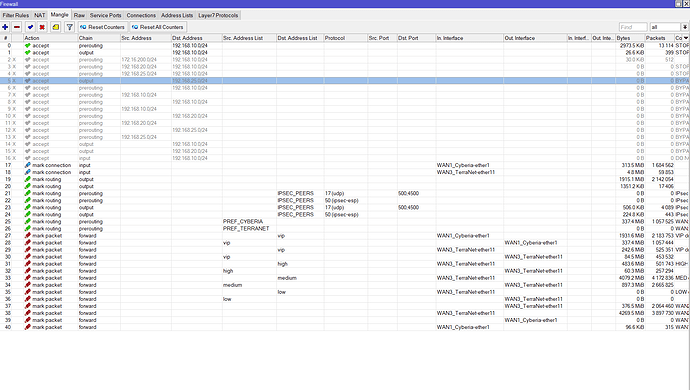

add action=accept chain=prerouting comment=
"STOP PBR - LAN to TIME(192.168.10.0/24)" dst-address=192.168.10.0/24
add action=accept chain=output comment="STOP PBR router to TIME VPN"
add action=accept chain=prerouting disabled=yes dst-address=192.168.10.0/24
add action=accept chain=prerouting comment="STOP PBR LAN20 to TIME VPN"
disabled=yes dst-address=192.168.10.0/24 src-address=192.168.20.0/24
add action=accept chain=prerouting comment="STOP PBR LAN25 to TIME VPN"
disabled=yes dst-address=192.168.10.0/24 src-address=192.168.25.0/24
add action=accept chain=output comment="BYPASS PBR router->TIME 25" disabled=
yes dst-address=192.168.25.0/24
add action=accept chain=prerouting comment="BYPASS PBR to TIME (LAN -> VPN)"
"BYPASS PBR from TIME (LAN <- VPN)" disabled=yes src-address=
192.168.10.0/24
add action=accept chain=prerouting comment="BYPASS PBR to TIME (dst)"
add action=accept chain=prerouting comment="BYPASS PBR from TIME (src)"
disabled=yes src-address=192.168.10.0/24
add action=accept chain=prerouting comment="BYPASS PBR to TIME 20" disabled=
yes dst-address=192.168.20.0/24
add action=accept chain=prerouting comment="BYPASS PBR from TIME 20"
disabled=yes src-address=192.168.20.0/24
add action=accept chain=prerouting comment="BYPASS PBR to TIME 25" disabled=
add action=accept chain=prerouting comment="BYPASS PBR from TIME 25"
disabled=yes src-address=192.168.25.0/24
add action=accept chain=output comment="BYPASS PBR router->TIME 10" disabled=
add action=accept chain=output comment="BYPASS PBR router->TIME 20" disabled=
"DO NOT connection-mark TIME VPN traffic" disabled=yes dst-address=
192.168.10.0/24
add action=mark-connection chain=input in-interface=WAN1_Cyberia-ether1
new-connection-mark=Cyberia_Conn
add action=mark-connection chain=input in-interface=WAN3_TerraNet-ether11
new-connection-mark=Terra_Conn
add action=mark-routing chain=output connection-mark=Cyberia_Conn
new-routing-mark=to_cyberia
add action=mark-routing chain=output connection-mark=Terra_Conn
new-routing-mark=to_terranet
add action=mark-routing chain=prerouting comment="IPsec IKE to WAN1"
dst-address-list=IPSEC_PEERS dst-port=500,4500 new-routing-mark=
to_cyberia passthrough=no protocol=udp
add action=mark-routing chain=prerouting comment="IPsec ESP to WAN1"
dst-address-list=IPSEC_PEERS new-routing-mark=to_cyberia passthrough=no
protocol=ipsec-esp
add action=mark-routing chain=output comment="IPsec IKE output via WAN1"
add action=mark-routing chain=output comment="IPsec ESP output via WAN1"
protocol=ipsec-esp
add action=mark-routing chain=prerouting comment="WAN: Prefer Cyberia"
dst-address-type=!local new-routing-mark=to_cyberia passthrough=no
src-address-list=PREF_CYBERIA
add action=mark-routing chain=prerouting comment="WAN: Prefer Terranet"
dst-address-type=!local new-routing-mark=to_terranet passthrough=no
src-address-list=PREF_TERRANET
add action=mark-packet chain=forward comment=
"VIP download from WAN1 -> PM_W1_VIP_DN" dst-address-list=vip
dst-address-type=!local in-interface=WAN1_Cyberia-ether1 new-packet-mark=
PM_W1_VIP_DN passthrough=no
add action=mark-packet chain=forward new-packet-mark=PM_W1_VIP out-interface=
WAN1_Cyberia-ether1 passthrough=no src-address-list=vip

add action=accept chain=srcnat comment="NO-NAT TIME 20->10" dst-address=

add comment="TIME 20 -> 10" dst-address=192.168.10.0/24 peer=TIME_GW
proposal=FG_P2_TIME src-address=192.168.20.0/24 tunnel=yes

The rule add action=accept chain=srcnat comment="NO-NAT TIME 20->10" dst-address=192.168.10.0/24 src-address=192.168.20.0/24 is on a correct position in chain srcnat so the issue you hit when pinging from the router itself and do not specify the source address is a different one than what you hit when pinging from a connected device - you can see that the ping from the router itself succeeds when you specify src-address=192.168.20.254. So the action=accept rule in srcnat does its job properly and the IPsec policy and SA are also working properly, and the issue must be either in the firewall (filter or raw, but I cannot see anything that would drop traffic from 192.168.20.0/24 to 192.168.10.0/24 there) or outside (a missing/wrong route to 192.168.10.0/24 via 192.168.20.254 on the external device you are pinging from). How does tracert 192.168.10.17 (Windows) or traceroute 192.168.10.17 (Linux/MacOS) look like on the external device?

it seems it is working from .20 subnet and i was trying from different vlan 172.16.200.0 and thats why it was not working
Thank you for your help
can you look to my firewall settings if there is anything i can enhance or it is good configured
sindy
February 11, 2026, 11:11am
11
You might want to clean up functional or verbatim duplicities - two rules accept everything that matches ipsec-policy=in,ipsec, another rule accepts everything that matches ipsec-policy=out,ipsec, but on top of these you also accept the same traffic using rules that match on src-address and dst-address.
You might save a tiny bit of CPU throughput by moving the rule action=accept chain=forward comment="VPN - Lan access" src-address=10.99.99.0/24 after (below) the action=accept chain=forward comment="FW: allow established/related" connection-state=established,related one in filter.
You also use a mix of “selective accept” and “selective drop” approaches in filter, which is useful in “single screen” firewalls but makes debugging of more complex ones extremely complicated. I personally prefer the selective accept one, i.e. drop everything that you haven’t explicitly accepted: your legal users let you know quickly if you forget to permit something, whereas your illegal users never let you know if you forget to block something.
Last, these two rules in mangleonly make sense if there are some IPsec peers in your LAN, as packets sent by the router itself do not pass through prerouting:
action=mark-routing chain=prerouting comment="IPsec IKE to WAN1" dst-address-list=IPSEC_PEERS dst-port=500,4500 new-routing-mark=to_cyberia passthrough=no protocol=udp
action=mark-routing chain=prerouting comment="IPsec ESP to WAN1" dst-address-list=IPSEC_PEERS new-routing-mark=to_cyberia passthrough=no protocol=ipsec-esp
And as you don’t have any public LAN subnet, handling transit of bare ESP doesn’t make sense at all - did this rule ever match a packet?
