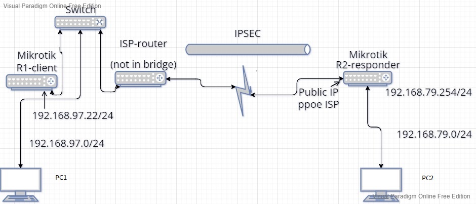

IPsec-strange thing to me happening.
Please, help.
I have thhose 2 Mikrotiks, and IPsec running.
everything worked fine, unitl i changed ISP. They brought their own router, which they have put it to the bridge, and then i’ve connected my Mikrotik RB 4011
to PPOE and i have internet. Then i ‘ve configured Ipsec. Only thing that is not working is :
1.can’t open web-page from PC2 on the remote side server.(Veeam Enterprise console web-page i’ve checked that is working from pc on remote side)
2. cant’ ping from router R2 to R1
When i do traceroute on R2 to 192.168.97.254 (gateway) traffic goes to internet.— this part is confusing me.
Everything else is working, like RDP from one side to another, explorer, ping from pc1 to pc2 and vice versa, also ping from client side router also works.
Don’t know how to solve this problems.
Please help.
R1_responder.rsc (18 KB)
R1_client.rsc (347 Bytes)

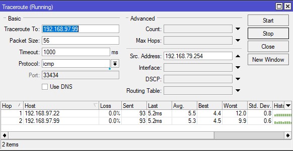

When you do traceroute in a network configured like this you need to set the source address to the router address on the LAN.
More detail on what @pe1chl wrote:
On R2, the only /ip ipsec policy row says
dst-address=192.168.97.0/24 … src-address=192.168.79.0/24 tunnel=yes
so only packets with source addresses from 192.168.79.0/24 are matched by that policy.
When the router itself sends a packet, it finds the route to destination, determines the gateway interface, and uses the address associated to that interface as a source one for the packet - unless a pref-src is set on the route, or unless you specify src-address when using commands like /tool traceroute, :ping, or /system ssh, or unless you use a src-nat rule.
=> it is normal that /tool traceroute 192.168.97.22 without specifying src-address=192.168.79.254 leads to getting the response from the WAN gateway.

You are right!
It works.
But what is with that web page on .97.0 network, that doesn’t want to open.( i can’t open even the ISP router page).

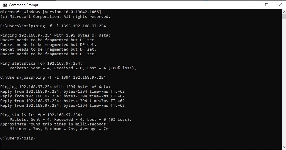

it seems like you have mtu issues. How you actually-mtu looks like on br-blackhole interface?
Here it is.
But if I may ask, isn’t this br-blackhole used only to redirect traffic to 79.0 gateway?
i only need to downsize MTU towards 192.168.97.0/24 network, correct me if i’m wrong.
Mangle rules are normally a workaround where you cannot make thw PMTUD work properly because most of the network is not under your administration, but yes, it will help here too.
Just bear in mind that MSS is 40 bytes less than MTU, and that the ping size in Windows is the size of the ICMP payload, i.e. 28 bytes less than MTU. So set the new-mss to 12 bytes less than what the maximum ping size.
