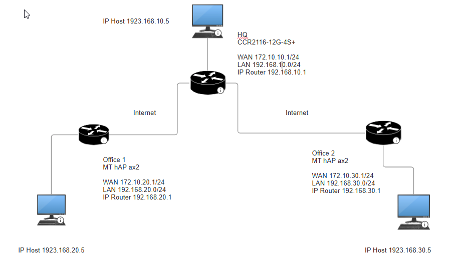

I’m having a big problem configuring an IPSec Site to Site tunnel. I don’t know why, but I can’t configure the tunnel between the 2 MTs correctly, I went through more than a dozen instructions and nothing works as it should. I received information that MT I have some problems with this configuration. Please help me how to configure Mikrotik devices correctly. The diagram below
In my case there is a big problem with connecting 2 MT together. The ping works, but only one way, host A to Host B.

Could you consider exporting your configurations to check what is already set?
probably a NAT problem
on office1
/ip ro add dst-address=192.168.10.0/24 gateway=172.10.20.1 pref-src=192.168.20.1
/ip fi na add action=accept chain=srcnat dst-address=192.168.10.0/24
on office2
/ip ro add dst-address=192.168.10.0/24 gateway=172.10.30.1 pref-src=192.168.30.1
on hq
/ip ro add dst-address=192.168.20.0/24 gateway=172.10.10.1 pref-src=192.168.10.1
/ip ro add dst-address=192.168.30.0/24 gateway=172.10.10.1 pref-src=192.168.10.1
/ip fi na add action=accept chain=srcnat dst-address=192.168.20.0/24
/ip fi na add action=accept chain=srcnat dst-address=192.168.30.0/24
