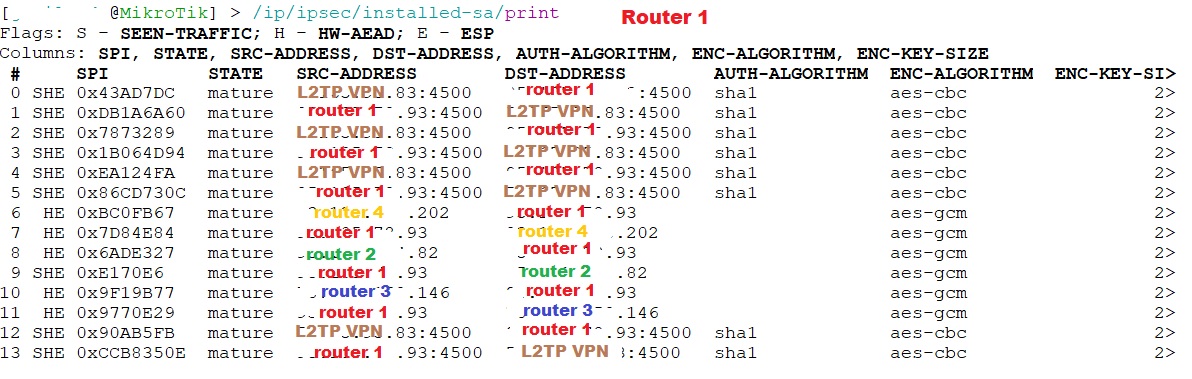

So to know for sure, look at the output of /ip/ipsec/installed-sa/print at Router1 and Router2.
  • Are there only addresses in the src-address and dst-address columns (which indicates that use of bare ESP has been negotiated) or there are also ports (:4500 after the address, which indicates that NAT has been detected and UDP-encapsulated ESP is used)?
  • Is this the same for the SAs towards Router1 on Router2 and the SAs towards Router2 on Router1, i.e. have both routers come to the same conclusion regarding presence of NAT?

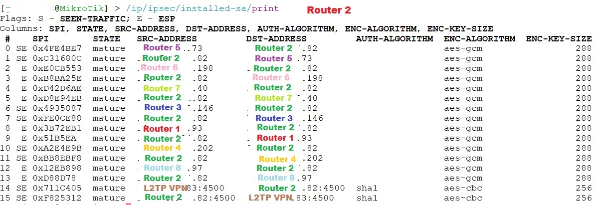

  2. Please find attached screenshots of /ip/ipsec/installed-sa/print on Router1 and Router2.
    For router 2 - there are more IPSec tunnels on this router and all of them are working fine - except tunnel from/to Router 1. All tunnels are configured with the same template, all firewall & NAT rules are same. In my first post I didn’t mention other tunnels just to simplify the problem’s description.
    L2TP VPN - it is my connection from home to specific router via L2TP IPSec VPN.
    In these screenshots You can see that all IPSec tunnels have no ports - ports are present only for L2TP VPN.

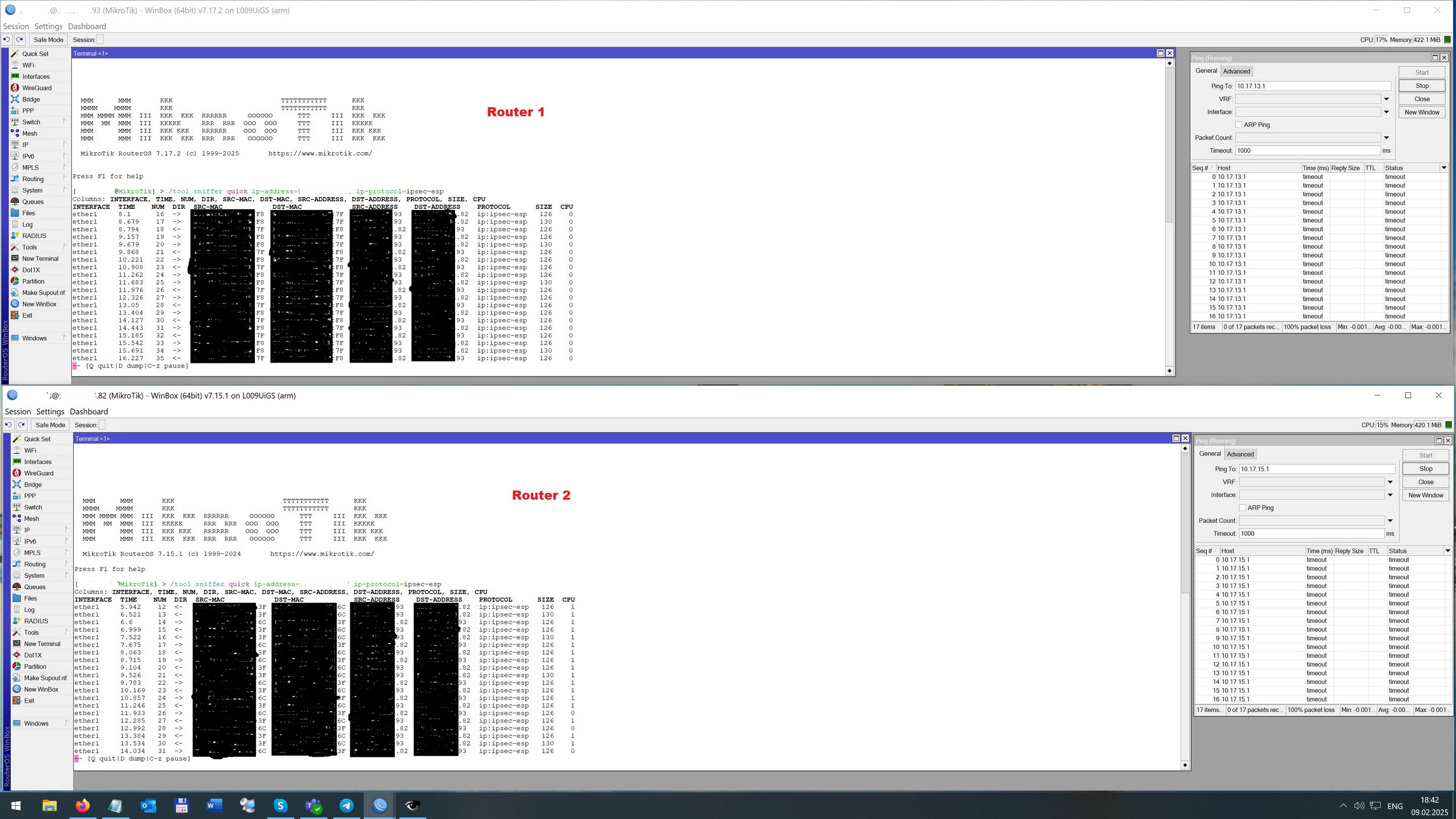

Please look at the screenshots below… It looks like I’m doing something wrong - because I don’t see exactly “outgoing” and “incoming” packets…

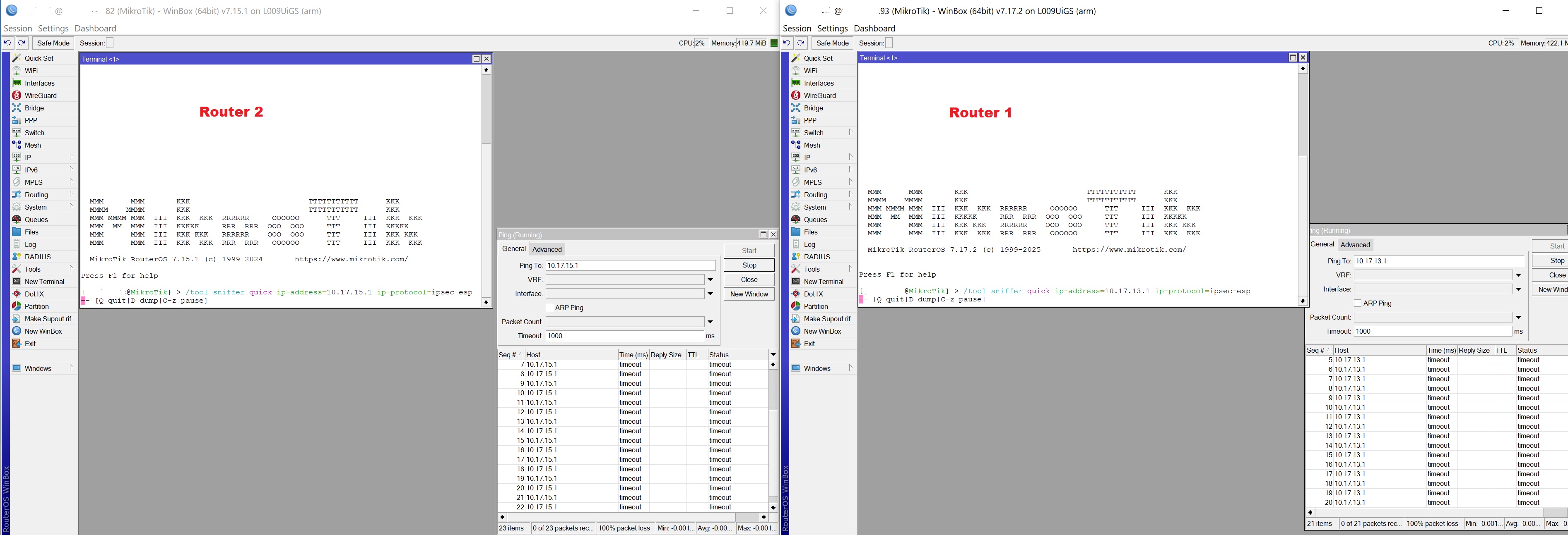

I wasn’t precise enough. Do ping from one LAN (private) address to another, but sniff for the public address of the remote router. It is enough to show Router 1 and the opposite router (2 or 3). And make the windows where you run the /tool sniffer as wide as your screen allows - Mikrotik dynamically chooses which columns to show depending on the available space, so we could easily lose some of them if the window was too narrow.
Dear Sindy,
Please take a look at this:
You forgot to obfuscate the addresses in the /tool sniffer command.
Do the ESP packets come synchronously with the ping ones, i.e. when you stop the pings, do the ESP ones stop coming?
Yes, as soon as I stopped the ping - the results in terminal also stopped

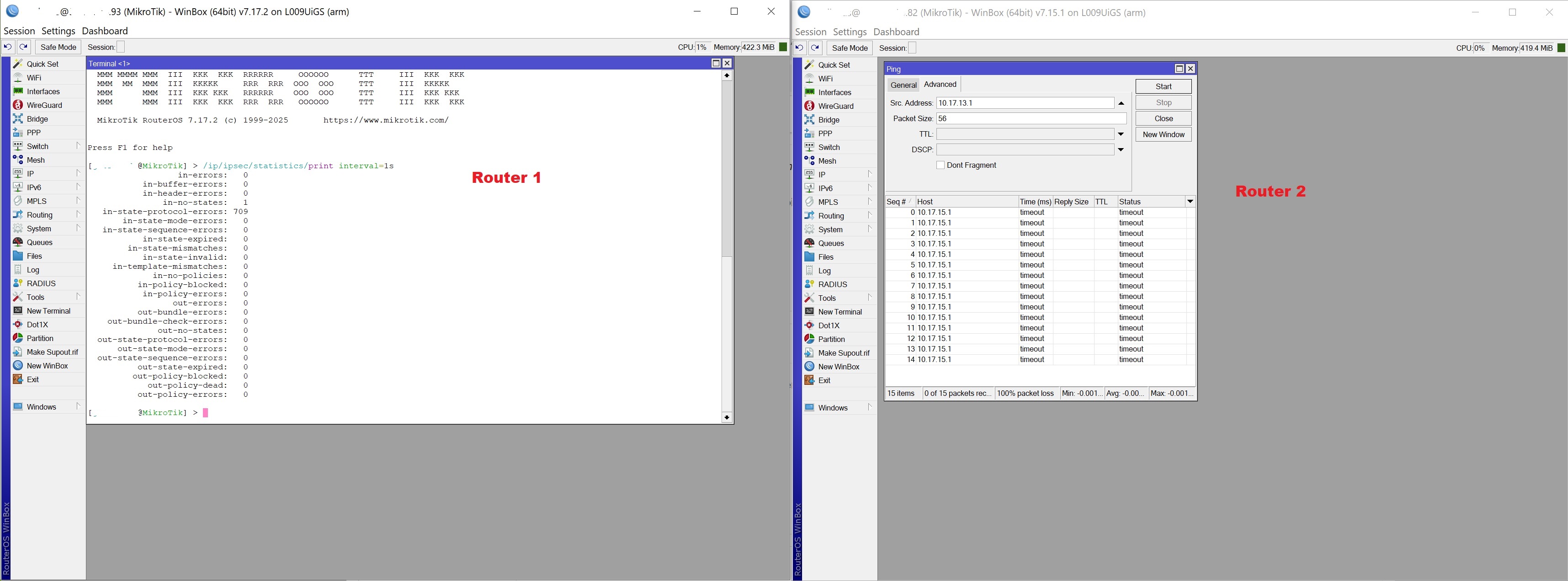

OK. So run /ip/ipsec/statistics/print interval=1s on Router 1, then start pinging the private address in Router 1 LAN from Router 2, then stop again. Does any value in the statistics grow while the ping is running and stays the same while it is not?
Yes, when ping works the statistics grow and when ping stops the statistics stop
OK, so most likely the 7.17.2 IPsec doesn’t like something about the ESP packets it receives from 7.15.x and doesn’t decrypt them.
