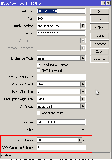

Have you tried the setting DPD (Dead Peer Detection)? If I understood correctly, it is exactly what you need.
