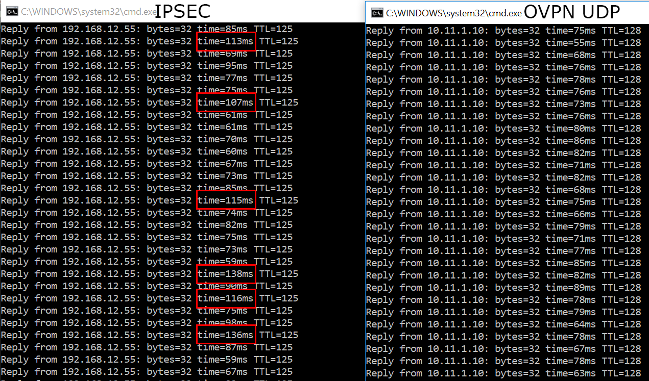

I have a question about IPSEC performance in comparition with OpenVPN in UDP mode - ipsec is slightly slower and the ping is no as equal as in OVPN.

But as the icmp packets on your screenshot have a 32-byte payload, the difference in ping reponse times is not caused by fragmentation. I’d assume each of the two connections uses a different encryption alghoritm. Also, with Mikrotik you cannot use OpenVPN in UDP mode, so what remote device have you actually used for the comparison?

Both VPNs (OpenVPN and IPSEC) works in hub and spoke architecture (both concentrators in OVH’s VPS).
OpenVPN encryption: cipher AES-128-CBC, auth SHA256, tls-cipher TLS-DHE-RSA-WITH-AES-128-CBC-SHA.
IPSEC encryption:
  • proposal: auth-algorithms=sha256 enc-algorithms=aes-256-cbc pfs-group=modp2048
  • peer: dh-group=modp2048 enc-algorithm=aes-256 exchange-mode=ike2 hash-algorithm=sha256
    SiteA: RB3011, SiteB: hexV3 (CPU ~ 0%).
