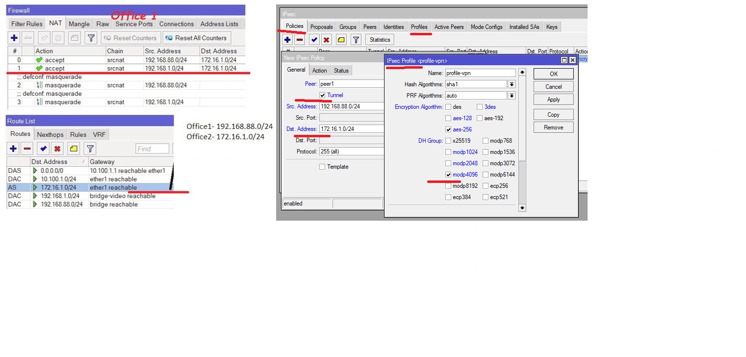

If everything is ok with your firewall rules (as in my example), then look at what is happening with the NAT section.
When creating a tunnel with a ‘‘other’’ router, we create a standard masquerade for our subnet and if necessary, create an additional masquerade for the other subnet (for example, video or other).
Srcnat addresses must be above Masquarade, otherwise the rules policy will work incorrectly. Srcnat will be your IP subnets and Dstnat will be Sophos remote subnets.
Then add the Sophos subnet to the ‘‘Route list’’ and specify the output (Wan). You need to pay attention to the ‘‘DH Group’’. In my case, the connection is to the Fortigate FW, yours will probably be similar. The DH on both sides must match.
I have created many tunnels this way and have no problems. In my case, the Mikrotik version everywhere is 7.16.2 I don’t know what version you have.

2- made the sophos initiate the connection and reduces all the encryption and authentication to AES256 and SHA256 and DH2048 only (i also removed all static routes from or to the mikrotik 192.168.1.0/24)
3 - I only used these firewall rules - but disabling the nat didnt affect the network
add action=accept chain=forward connection-state=established,related dst-address=192.168.1.0/24 src-address=192.168.140.0/24
add action=accept chain=forward connection-state=established,related dst-address=192.168.140.0/24 src-address=192.168.1.0/24
add action=accept chain=srcnat dst-address=192.168.140.0/24 src-address=192.168.1.0/24
