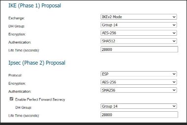

Thank you for the answer, however a new ipsec error pops up, identity identity not found for peer: ADDR4:
I am attaching the log and IPsec settings can you please check if everything is set correctly?

Many things may be wrong, but what seems most likely to me is that when you disable and re-enable the peer, the Mikrotik acts as an initiator and the connection succeeds, whereas when the Sonicwall acts as an initiator during the IKE renewal, the Mikrotik acting as responder doesn’t like the combination of CERTREQ coming from there and ID_I being an IP address when remote-id is set to auto.
So /ip ipsec identity set [find where peer=ipodnik-peer] remote-id=address:46.234.101.177 might help. To possibly see the result faster, maybe do not change the remote-id yet, and start from setting passive=yes on the peer at Mikrotik side, disable the peer, and re-enable it; if my assumption is correct, you should see the same error. If you do, change the remote-id as suggested above; if that helps, chances are high that the renewal will succeed as well, so you can set passive back to no and wait 8 hours for the final outcome.
