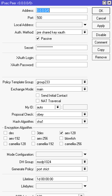

On the main office1 side you’ll create a peer of 0.0.0.0/0 and tick the “generate policy” option. You’d do the same only specify the office1 ip on the other (office2) end.

Create policy template instead of an ordinary policy, then specify that template in the peer configuration. Also enable ‘generate policy’ option in the peer config.

Generate policy creates a policy as was requested by the initiator (client). Policy groups and policy templates allow you to check/restrict the policy to be created.
You can not use static policy on the responder, since the initiator’s IP is not known in advance. That’s exactly the case ‘generate policy’ option exists for. You should specify the correct policy in your “Office 2”, and similar (inverted) policy will be created in your “Office 1” automatically.

And, by the way, the use of policy groups/templates appears to be mandatory since early 6.x for generate policy to work correctly. At least I remember myself having some troubles with generate policy in 6.7 or 6.8 that disappear as soon as I defined the correct policy group.

No need Nat Traversal on passive side.

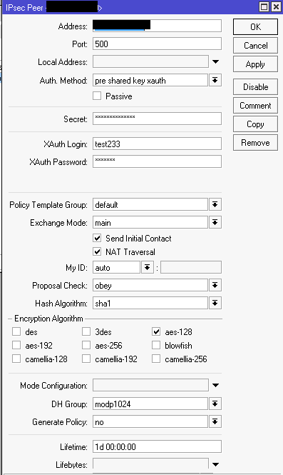

IPsec config from Office2 Mikrotik:
/ip ipsec export
/ip ipsec proposal
set [ find default=yes ] auth-algorithms=md5,sha1
/ip ipsec peer
add address=[office1ip]/32 auth-method=pre-shared-key-xauth enc-algorithm=aes-128 secret=xxxxxxxx xauth-login=test233
xauth-password=xxxxxxxx
/ip ipsec policy
add dst-address=[office1localnet]/24 sa-dst-address=[office1ip] sa-src-address=0.0.0.0 src-address=[office2localnet]/24 tunnel=yes
You’ve got it wrong. The use of NAT-T is something that both VPN endpoints should negotiate. If it is disabled on one of your VPN endpoints, then neither use it.
The ‘sa-src-address’ parameter should be the real external IP address of your Office1.
Try changing the above mentioned settings. If tunnel doesn’t start working, please share the ipsec configuration from your Office1 router as well, please.
