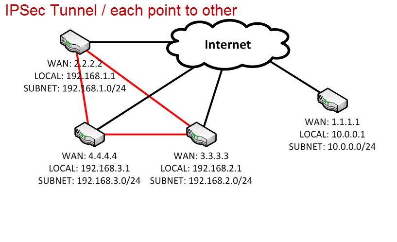

I have 5 remote Clients (Satellites) and I have everyone of them to bind (tunnel) with the Main PBX.
For the moment I’ve made tunnel on every Satellite for every satellite + for then Main PBX, in order every satellite to reach the other .
How can I do than with only one tunnel from the Client to the office in order to minimize the configuration?
I suppose you can create a Hub like topology all sites tunnel into main
Clients connect to Hub, I wouldn’t a good result for voip calls over Sat tho.
i cant make sense of you tho your hard to understand
draw pic ?

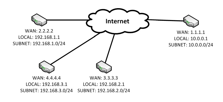

From what you describe it seems you are doing IPSec in tunnel mode with policies for whole subnets.
For the topology you are describing, use a GRE tunnel, IPSec in transport mode and a routing protocol like OSPF to distribude the routes to clients. Like that, you will just need one tunnel from the remote client to the concentrator, and the concentrator will route all the traffic between the remote subnets.
On the second picture (ipsec tunnel) is what I’ve made , using tunnels on each point to other.
On the first is what I need in order to avoid large scripting … (all my wan address are dynamic IP, so I have to manage them via no-ip services and update the policies dynamically on every change)
