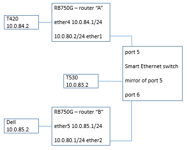

I’m working on a setup that will eventually turn into a site-to-site VPN via the internet. For now it’s a collection of “test lab” hardware all on one desk for easy testing. The topology is as shown in the attached image: one laptop connected to router A using the 10.0.84.0/24 network, one laptop connected to router B using the 10.0.85.0/24 network, the two routers linked together via a smart switch and using the 10.0.80.0/24 network. The smart switch and the laptop attached to it represent the internet; I’ve configured port mirror on the switch so that the attached T530 laptop can capture traffic between the two routers.
If I add the appropriate static routes (on A a route to 10.0.85.0/24 via gateway 10.0.80.1; on B a route to 10.0.84.0/24 via gateway 10.0.80.2) then all 4 devices (T420, Dell, router A, router B) can ping to every other device. When I run wireshark on the T530 it can see the unencrypted traffic between routers A and B.

The trouble is, every how-to I’ve read gets to this point and says “That’s it! Traffic should pass through the link now.” But when I try to ping from T420 or from router A to either 10.0.85.1 or 10.0.85.2 I’m told there’s no route to host. Sure enough, there’s nothing in the routing table for that. If I put my static routes back the pings go through but they’re not encrypted; they go along side the VPN tunnel rather than through it.

If you don’t have any, then e.g. router A only knows where to find 10.0.84.0/24 and 10.0.80.0/24. It has no idea where to look for 10.0.85.0/24.
Two directly connected routers are confusing for testing IPSec, because you’re missing the usual internet between them. In order it to work, you have to set both routers as default gateway for each other. But then it’s not immediately clear if traffic flows between LANs encrypted or not.
If you have third router, put it between those two and make it play the role of internet. If you don’t, then you need to check IPSec statistics or look for ESP packets (protocol 50) on WAN interface to see if it works. Or you can block unencrypted traffic to other LAN using firewall filter.
Edit: Also your /ip ipsec policy config is wrong, it has .83 subnet, but according to image it should be .84.
