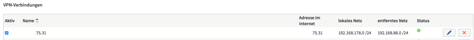

RouterOS tells me that the VPN is established…also Fritzbox shows as connected and displays local and remote prefix correctly…

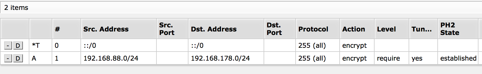

Maybe the remote site isn’t reachable as in the ipsec policy tunnel is checked and I can’t uncheck it?
If I want to uncheck it I get:
 Couldn't change IPsec Policy <192.168.88.0/24->192.168.178.0/24> - transport mode policy must match sa endpoints (6)

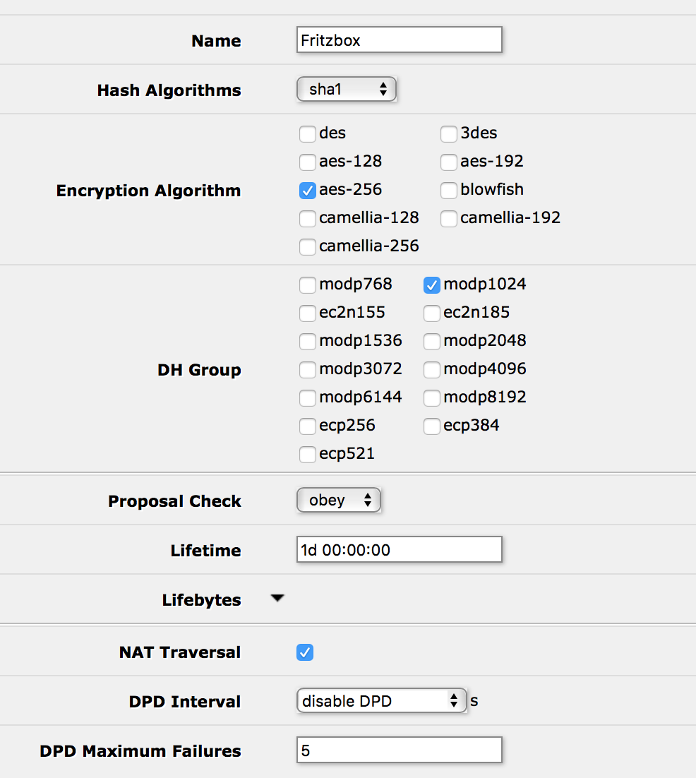

Needed to check “NAT traversal” in the profile :wink:

On fritzbox just create a new lan2lan vpn, no need to upload any fancy configuration…

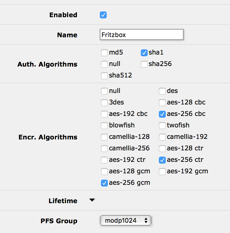

On routeros side:
VPN proposal:
VPN profile:
