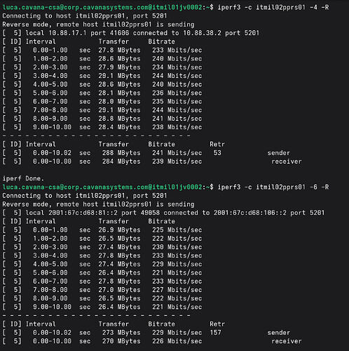

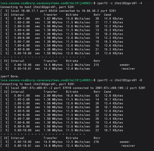

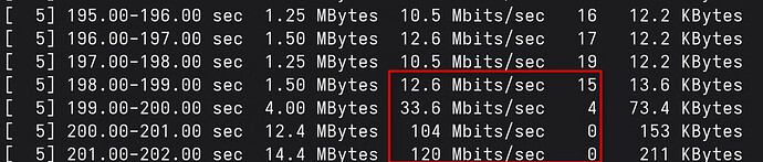

From the Palo Alto side ("PaulloHQ") to the Mikrotik side ("Mazzini59") it consistently goes slow with many packets lost and retransmissions until after some times packets lost magically stops and speed goes up to 200 mbits.
As you can see in the following picture (it's a reverse iPerf from itmil01jv0002 (PaulloHQ - Palo Alto side) running in server mode - generating traffic - to itmil02pprs01 (Mazzini59 - Mikrotik side).
There is no way to anticipate after how long it will stop dropping packets and then start running at full speed, it just happens if you wait long enough. It does not change anything running in IPv4 or IPv6, the behavior is the same.

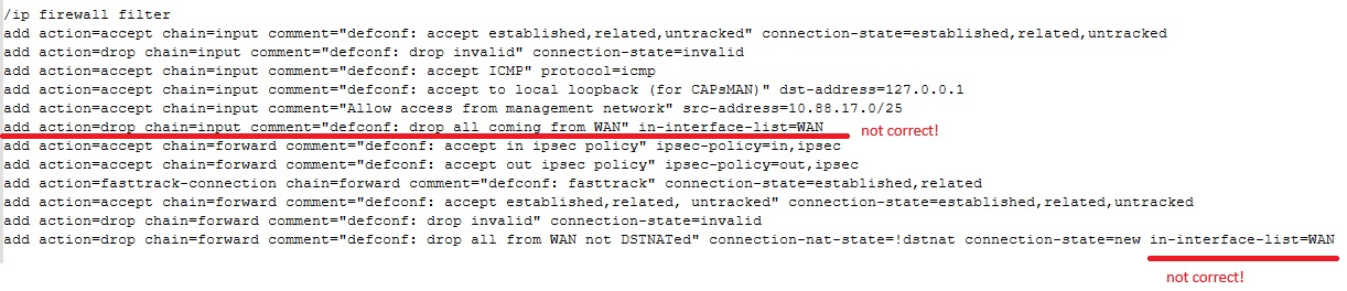

Here's the complete device config. Connection tracking is disabled for what comes from the IPSEC tunnel.

add action=accept chain=input comment="defconf: accept to local loopback (for CAPsMAN)" dst-address=127.0.0.1
add action=accept chain=input comment="Allow access from management network" src-address=10.88.17.0/25
add action=drop chain=input comment="defconf: drop all coming from WAN" in-interface-list=WAN
add action=fasttrack-connection chain=forward comment="defconf: fasttrack" connection-state=established,related
add action=accept chain=forward comment="defconf: accept established,related, untracked" connection-state=established,related,untracked
add action=drop chain=forward comment="defconf: drop all from WAN not DSTNATed" connection-nat-state=!dstnat connection-state=new in-interface-list=WAN

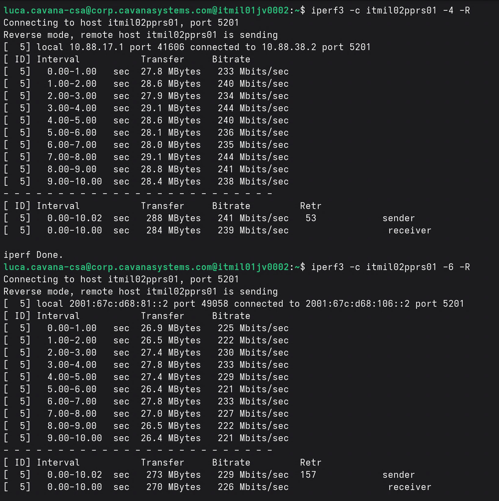

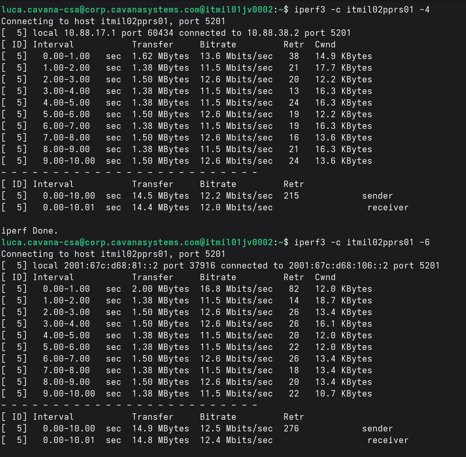

Now that I moved this device where it should belong it established again the VPN to the Palo Alto and that's the result from iPerf:
HQ to Mazzini59 (Palo Alto to MK):
Mazzini59 to HQ (MK to Palo Alto)

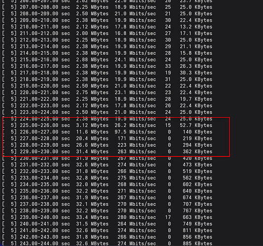

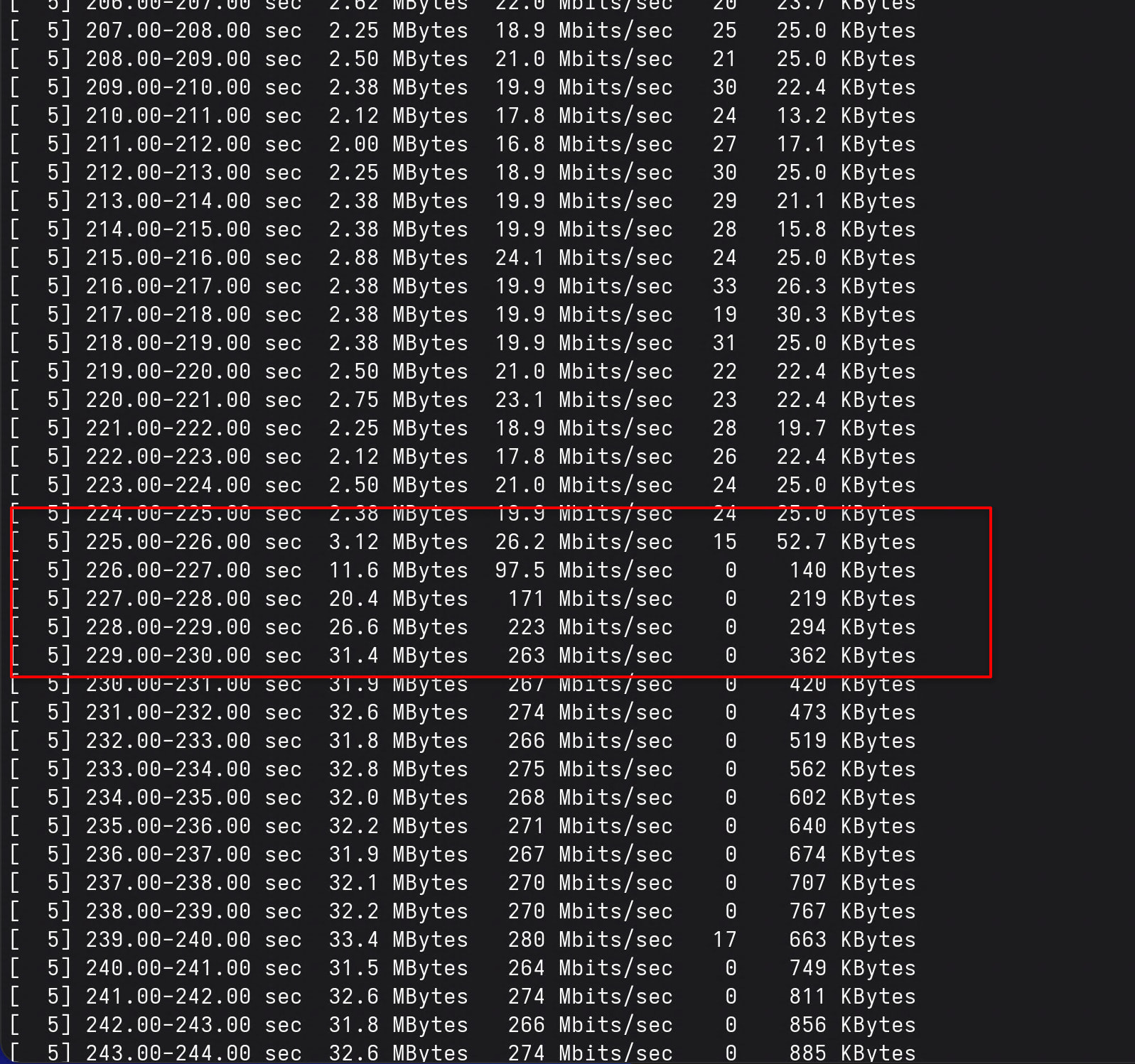

It went back to how it was behaving in the beginning. If I leave the iPerf running for some time, then it stops re-transmitting packets and the speeeeed goes up.
Again, if I exclude the local ISP from the loop by connecting the Mazzini59 MK to my HQ border router it goes straight to 300 mbits with no retrans.
I'm quite convinced it's the ISP fault. Does anyone have any ideas how to nail them? They refuse to cooperate.

I'm more inclined to think it's a firmware bug on some box on the path. What I've seen this morning is that as long as there is some minimal amount of traffic dripping through the VPN then an iPerf session immediately maxes out at 300mbit/s (the most one of the ARM core of the MK can handle with current AES256-CBC encryption).

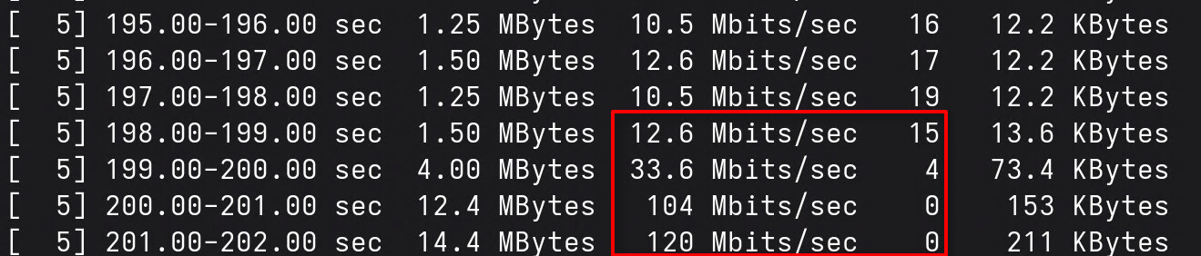

If you leave the VPN essentially idle for some time then it takes a casual length of time to iPerf to go back to 300mbit/s; it stays at always the same amount around 20 mbit/s then jumps upwards.
This for the direction from HQ to Mazzini59, the reverse always always maxes out at 300mbit/s immediately.

Okay, that actually gives a few more clues.
A few tens of lost packets out of 15,000 works out to roughly 0.1–0.3% loss, which is definitely enough to seriously cripple a single TCP stream (assuming those packets are actually lost and not just missed in the captures).
The idle-dependent behavior is also interesting. If a little traffic keeps the tunnel "in a good state", but after some idle time it comes back at ~20 Mbit/s and then suddenly jumps to 300, I'd suspect some kind of stateful behavior somewhere along the path, like policing/QoS, ECMP/LAG/path selection, forwarding cache, or maybe a firmware bug in some box along the way, like a flaky switch or something similar.
A crypto/IPsec bug might look similar too, especially on the inbound/decryption side. ESP arrives as it should, but some packets disappear somewhere inside the IPsec/crypto path and cause TCP retransmits. The fact that the same box immediately does 300 Mbit/s when you bypass the ISP path argues against that though, unless something about the packet timing/bursting on the normal path triggers it.
One more thing you can check is comparing the slow and fast phases separately:
  • ESP packets sent by PA vs received by MT.
  • /ip ipsec statistics, especially in-state-protocol-errors and other in-*errors.
  • /ip ipsec installed-sa print detail and check hw-aead.
  • /tool profile cpu=all.
If possible, also capture the decrypted traffic after IPsec on the MikroTik side. If ESP arrives on WAN but the corresponding inner packets disappear, then the MikroTik IPsec/crypto path becomes a much stronger suspect.
I'd also try UDP with iperf3 at different fixed rates during the bad state, e.g. 10/20/30/50/100 Mbit/s. If loss suddenly starts above some fixed rate, that would look a lot like policing/rate limiting somewhere in the provider path.
If you were seeing the same behavior all the time regardless of ISP, I'd probably suspect a ROS bug and open a support ticket. But what you're seeing sounds more like an external problem somewhere "along the path".
That's unfortunately about all I can think of for now. Please keep us updated if you find anything else.
Good luck!

I would suggest you to change your firewall rules because they are a bit incorrect. This will affect your traffic flow, speed, stability.
LAN=Bridge
WAN=internet
add action=drop chain=input comment="drop all else"
add action=accept chain=forward comment=“internet traffic” in-interface-list=LAN out-interface-list=WAN
add action=accept chain=forward comment=“port forwarding” connection-nat-state=dstnat
add action=drop chain=forward comment=“drop all else”
In the input chain it makes sense as an optimization to
But anyway I've filtered listening services to specific networks that are behind the VPN and for those filtering is made at the other end, still, you are right.
What I don't understand is why you state the I should
The first rule is already happening as the router will forward anything to anything, the second and third rule are a more complicated and incorrect way to do what the router already does; incorrect because it will also drop the traffic I intend to flow between interfaces.
It may be correct if it's a simple home router with two interfaces "LAN" and "WAN" but that's not the case.
Mikrotik has two basic configuration principles, 1) everything is allowed and only what you define yourself is forbidden (by default). 2) everything is forbidden and only what we need is allowed. This is the recommended method.
You are using the ''default'' method, where everything is allowed, but with small errors that affect traffic flow. Unfortunately, the Mikrotik firewall is not like Fortigate, Sophos...., where the policy specifies who, where and what will be accessed and at the end the last rule is always drop=All and everything. For Mikrotik, the Input chain is a section where incoming traffic is, but the forward- section is a section where we specify all traffic that flows through the router. The recommended method is to end the rules with drop=All at the end of both these sections. Then everything will be correct and if by chance we do not get to some resources, then we define the necessary rule for the forward chain. It can be, for example, accept to Vlan10 to Vlan20 etc etc... According to the example I copied for you, I have 8 branches working in tunnel mode. The traffic flow is correct all the time, no problems have been observed. If I ever experience communication interruptions, 99.9% of the time it's the provider's fault.
