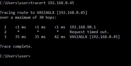

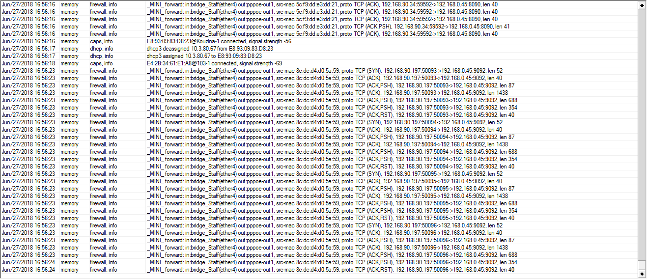

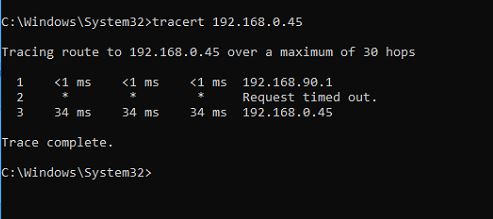

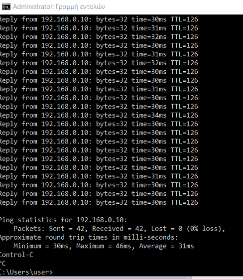

Hello my friend. They told me again that it dropped but the ip was already changed and couldn’t perform the traceroute test. I did though anyway. One pc get the ip but the other pc also has the hostname. I can see also other devices like a server properly.
