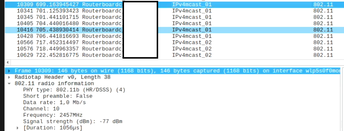

I managed to capture in monitor mode while a cut occurred.
Here you can see the packets from ax2 to tv box (Commscope), and suddenly, some strange packets, seems that the conversation stops. I do not have too much more knowledge to see what is happening here. I will send the capture file to support in case they want to continue the investigation.
Whatever happens in your captures, it is some strange stuff. Something for MT to investigate.
I sent the file to support. Hope they can get some useful info.
