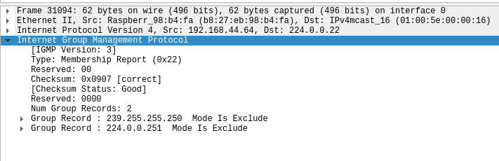

I configured Port 1 as a span port and attached Wireshark to it. I can see my Kodi box sending IGMP Join messages, but it’s like SwOS is ignoring them and not adding the device to the group.
(Note: “Mode is exclude” confused me for a second, but according to RFC 3376 it’s how a Join message looks like

UPDATE: I realized after attaching Wireshark to the CRS309 VLAN 44 interface that:
  • with IGMP snooping enabled the IGMP Join/Leave messages from Kodi are NOT relayed to the CRS309
  • with IGMP snooping disabled I can see the IGMP Join/Leave messages on the VLAN interface
