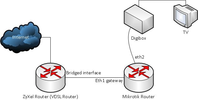

Thanks for the answers! Export compact output can be found from the attachments as well as my topology.
I have V5 not V6.
