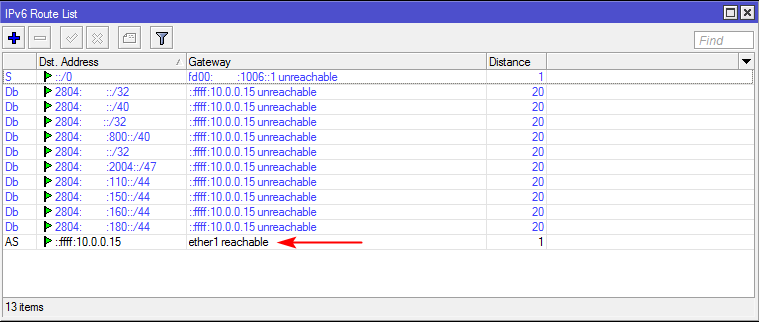

It seems RouterOS is recognizing IPv4-mapped, but still doesn’t resolve it as next-hop:
