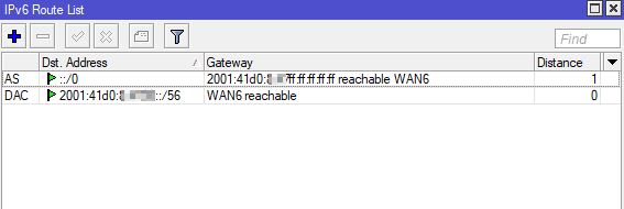

I am working with OVH and I have some server working under vmware with IPV6.
I tried to configure a mikrotik with IPV6 and it works local but the IPV6 gateway dont works
The configuration is simple, we have a /64 network, and the GW is a /56
example, for this IPV6 network 2001:41d0:1111:5678::/64
Ip for mikrotik 2001:41d0:1111:5678::1/64
Ip for Gateway 2001:41d0:1111:56ff:ff:ff:ff:ff
You need add a route to 2001:41d0:1111:56ff:ff:ff:ff:ff in the ipv6 interface or you can define the ip as /56 (work properly with linux)
If I define ipv6 as 2001:41d0:1111:5678::1/56, the mikrotik shows the gateway as reachable but it doesn’t work
if I define the ipv6 as 2001:41d0:1111:5678::1/64, and add a route to 2001:41d0:1111:56ff:ff:ff:ff:ff, the mikrotik show the GW as unreachable
Can you help me?
Anyone install a mikrotik IPV6 in OVH server ?
Hey,
I encountered the same problem. You get allocated a /64 but the network OVH uses is a /56, so you need to change your IP address to 2001:41d0:1111:5678::/56 and set the IPv6 gateway to 2001:41d0:1111:56ff:ff:ff:ff:ff.
Reference: http://blog.nirkabel.org/2018/05/14/vmware-esxi-on-ovh-coms-dedicated-server-additional-ipv4-subnet-and-native-ipv6-connectivity/
Good luck!
