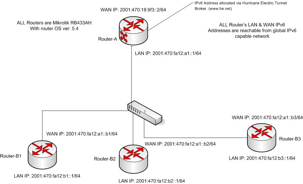

Dear fewi,
I have attach my network diagram for your better understanding. I have connected with
Router-B3 and my ipv6 address is 2001:470:fa12:b3::2/64 & gateway is: 2001:470:fa12:b3::1
From Router-B3 new terminal console I can ping to outside world, say 2001:470:20::2 with my
src-address: 2001:470:fa12:b3::1 but I can not go our from my PC having IPv6 address:
2001:470:fa12:b3::2 & gateway 2001:470:fa12:b3::1
I have added my entry of mac in IPv6/ND >prefix tab as:
prefix: 2001:470:fa12:b3::2 interface : lan
I hope I can explain my problem.
Best Regards
