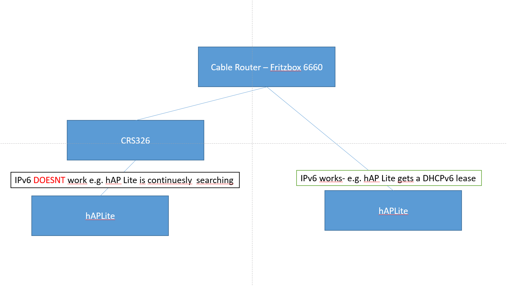

im having the issue that behind my CRS326 i dont get IPv6 up and running.
What could filter the DHCPv6 ?
STP is off, IGMP snooping is on on the local bridge.
CRS is not routing !

Hi
config2.rsc (6.84 KB)
IGMP snooping and IPv6 don’t go well together on Mikrotik …
confirmed.
