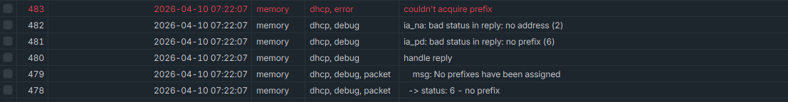

I have a CCR2004 that seems to keep looping on getting DHCPv6-PD Address and Prefix.
It goes through the cycles but always ends in Status Error and the logs showing the last message as
”couldn’t acquire address/prefix”.

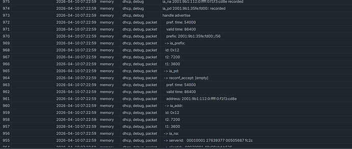

From previous logs it does look like it receives the address/prefix but is unable to commit the configuration in RouterOS?
Shows that it has recored the prefix/address
Then goes a few cycles and reaches.
and errors out
