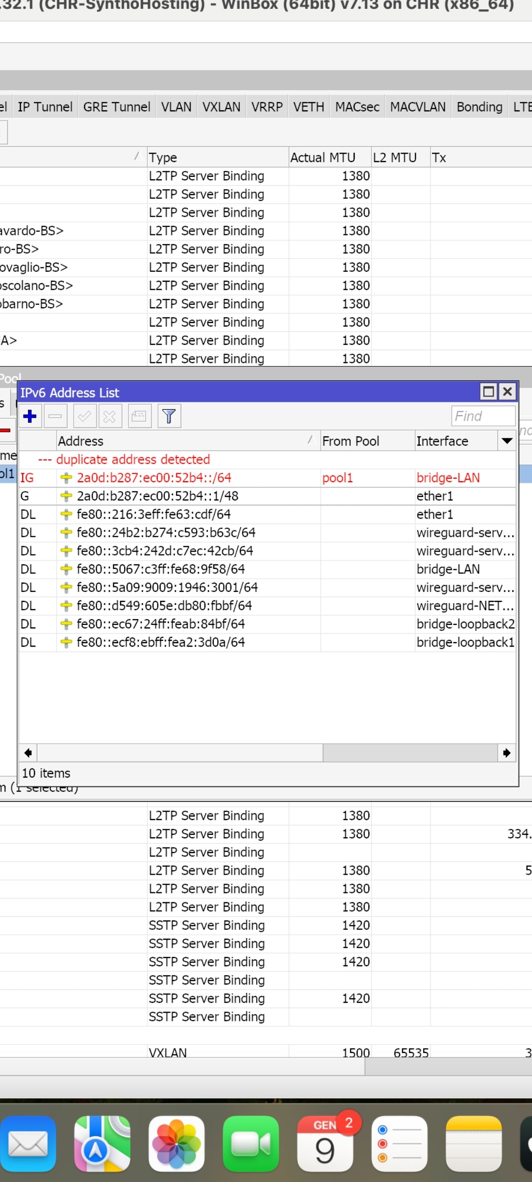

whoever provides me with the connection advertises
2a0d:b287:ec00:52b4::/64
the gateway is
2a0d:b287:ec00::
I configured the router in this way.
/ipv6 address
add address=2a0d:b287:ec00:52b4::1/48
/ipv6 route add dst-address=::/0 gateway=2a0d:b287:ec00::
is this incorrect?

In the meantime, thank you for your valuable response. I’m not an IPv6 expert. In any case, I was given an indication of the /64 assigned and which gateway it is. At this point the doubt remains as to which subnet to indicate in the IP address and whether I should take the address from the pool or ask the ISP which one to use.

as already mentioned the address assigned by the provider is
The gateway Is
2a0d:b287:ec00::
The pool Is
2a0d:b287:ec00::52b4::/64
If all the data is known, substitute it into the commands, that I wrote earlier.
And check.
Error
  1. Your messages indicate either different addresses or incorrect ones.
  2. If you are given a pool
, then the address for your interface that goes to the provider cannot be
Because this address already belongs to your pool.
You can assign address
to the interface, that will advertise addresses for your local network. Although this is not entirely true. And for the WAN interface you need a different address that will be in the same subnet with the default gateway to the provider.
