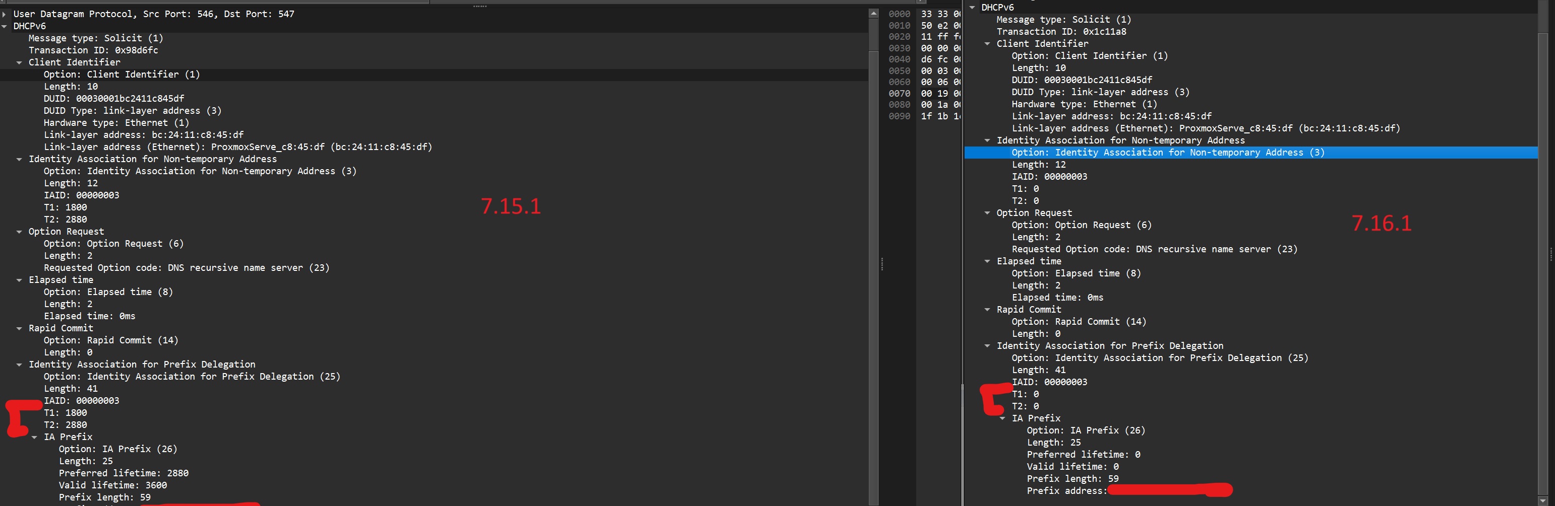

When I recently upgraded to 7.16.1, I noticed that this seemed to no longer work. I still get a IPv6-PD response back, and router OS binds, but the modem will reply back to with a random prefix. Not the one I have set with a hint. I rolled back from a backup and I ended up getting two packet captures. One on 7.15.3, and one on 7.16.1, and I have those attached.
I only saw one small difference, and that was with T1 and T2 values in the request (which I also assume corresponds to preferred and valid lifetime under IA Prefix). Apparently from a quick google search these values are “T1(renew) and T2(rebind)”. Maybe I’m missing this, but I do not see any mention to these being able to be set to a value in the documentation. My only guess is that the Comcast modem expects very specific requests, and with T1=0 and T2=0 it just ignores the prefix-hint request, and replies back with a random /59 out of the /56.
