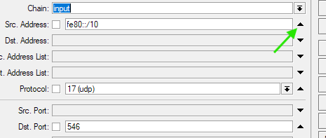

As for the DHCPv6 issue, do you use the defconf firewall configuration or something similar? If yes, check the rule with the comment "defconf: accept DHCPv6-Client prefix delegation." and try to temporarily remove the condition src-address=fe80::/10:
Yeah I tried that, didn’t work. All ipv6 firewall counters are at 0, bar the first untracked accept rule, those are rising because of other devices on network are sendig solicit packets.
