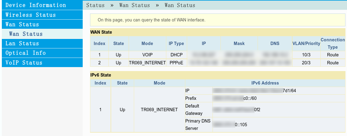

The ISP does have good support for IPv6, and when I connect through the ISP provided modem I get an IPv6 address and it passes the checks at ipv6-test.com. From the ISP provided modem this is what the correctly working IPv6 status looks like I when I connect directly from it:
Somwhere in the modem config I saw that it was using SLAAC, which I gather is not good for compatibility with Mikrotik. Any other suggestions? Thanks!
